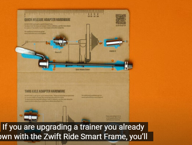

Hi I have got a question Is the adapter included if you decide to buy only the frame?
Thank you for the responses :pray: I’ve got my frame secured now, I dismantled and reassembled the Zwift Cog and now working well (guessing I didn’t install it properly the first time around). So if you’re installing the Zwift Cog on an existing trainer take care (or at least be less ham fisted than I was)
My Zwift Ride frame didn’t have the adapters however the ones you need might have been provided with your smart trainer (they were for my Kickr Core that I bought a couple of years ago).
If not you can order replacements from Wahoo for about £30
My zwift ride frame wont fit into the kickr hub. Its too tight, really to tight… ive tried to expand the frame so it will be larger and fit into the hubs but damn… nothing close like the video i saw , ive used the C + D adapter but seem like my frame hasnt been build wide enought. He dont seem damage too.
Kinda desperate… just received that today and got no idea what i can do here.
Hi @Stephane_Poirier_JZQ
Shuji at Zwift HQ here.
The Ride frame uses a 142 mm spacing. It sounds like the left (non-drivetrain side) might be using the adapter for a 148 mm frame?
Please make sure your trainer has the correct axle adapters installed. When you say KICKR Hub - do you mean the Zwift Hub trainer that Zwift sold until earlier this year? If that’s the case - you may want to contact Zwift Support to verify that the correct spacers are installed. Please include photos - they will help a great deal to see what’s happening.
If you meant a trainer made by Wahoo - please also check that the non-drrivetrain adapter is oriented correctly for 142 mm spacing.
