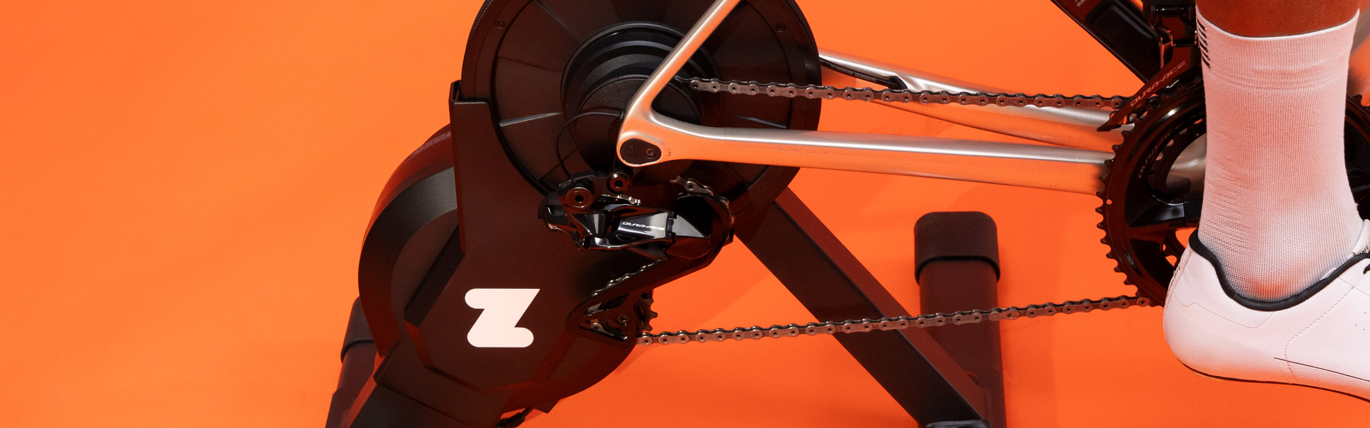

The Zwift hub one is on sale with a 10% off code, includes a year of zwift membership too so that puts it within your budget… of course you need a bike to put on it, assuming you have one.
Thanks for the suggestion, Mike, ill look into it, but I would prefer something like the Merach that’s fully functional with zwift.

I think Mike was suggesting it would be cheaper to buy a smart direct driver trainer (which does all the things you want) and using it either with a bike you already own or a used bike you could buy.

Thanks, yes, I understood what Mike was suggesting, and if I can’t get the Merach to work I will probably get the trainer.
