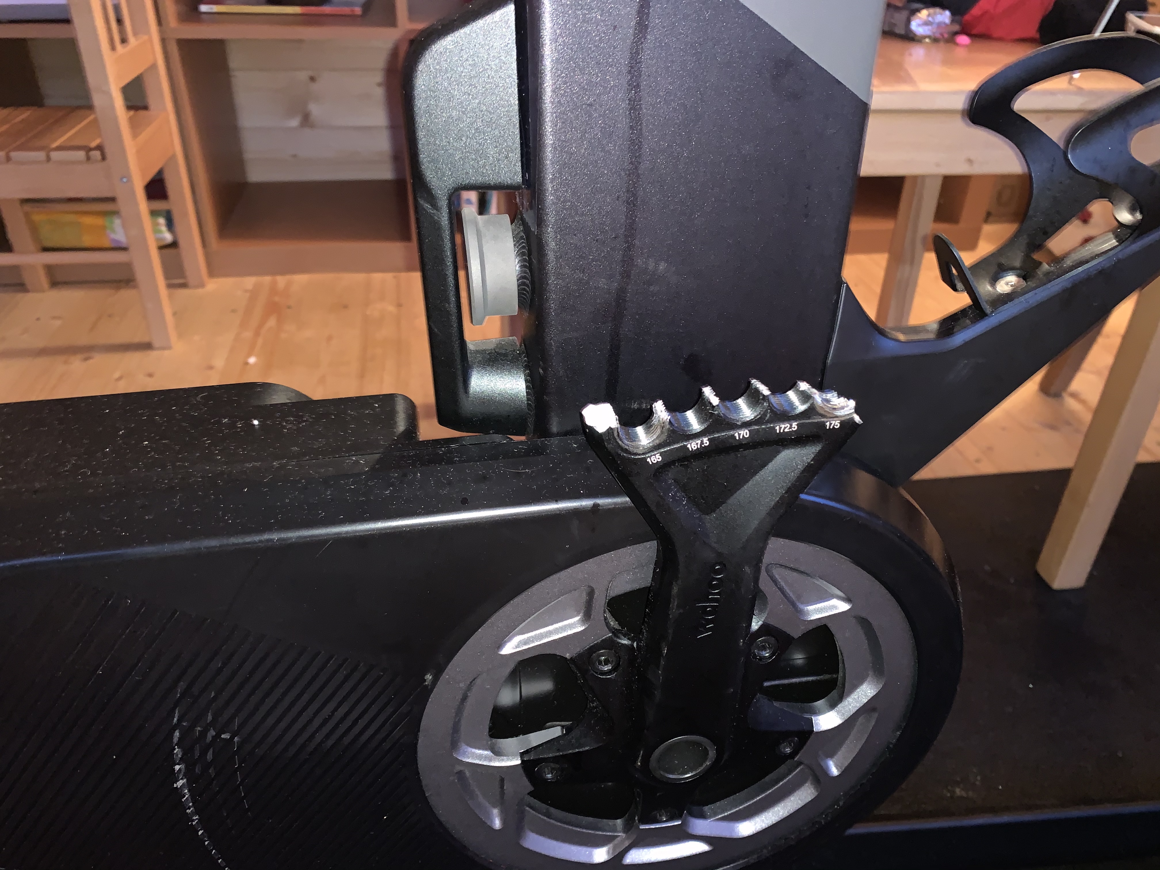

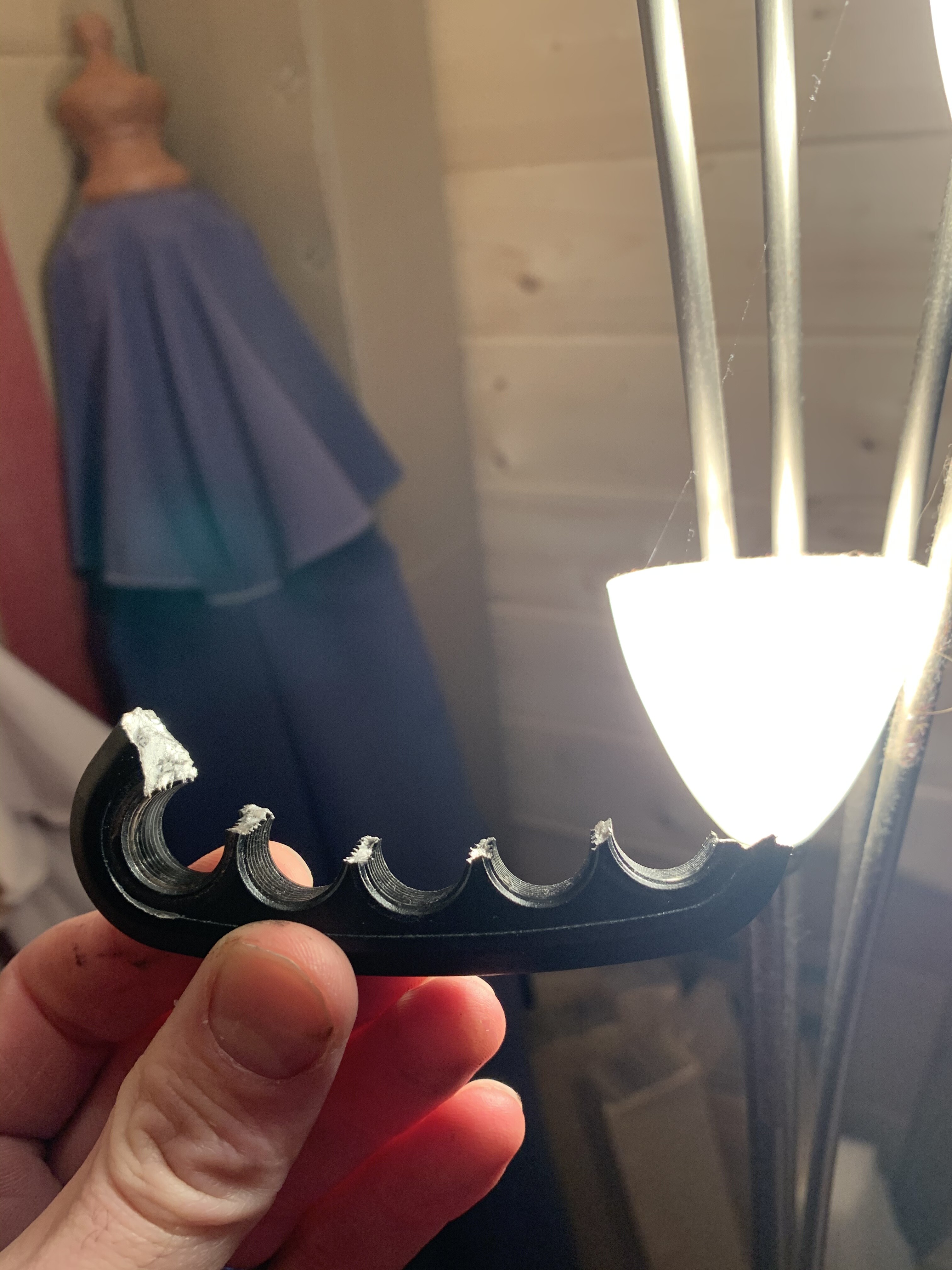

I’ve had my kickr bike since July. It has been great up until now when a slight knocking sound started to happen. After some back and forth emails with Wahoo a replacement is being shipped (the deposit option).
In the meantime the bike was fine to ride apparently. Then this happened:
Yes, I’m experiencing the same issue. Somehow the gear spacing is a little off for those cogs. Maybe setting up the gearing as Di2 sync with triple chainrings and an 11-25 cassette. I’m going to try a different setup tomorrow…
Holy Toledo! I know a few guys how’ve experienced that failure IRL and ended up with broken collarbones. My BiL had a concussion and got transported to the hospital. Hope you’re doing okay.
