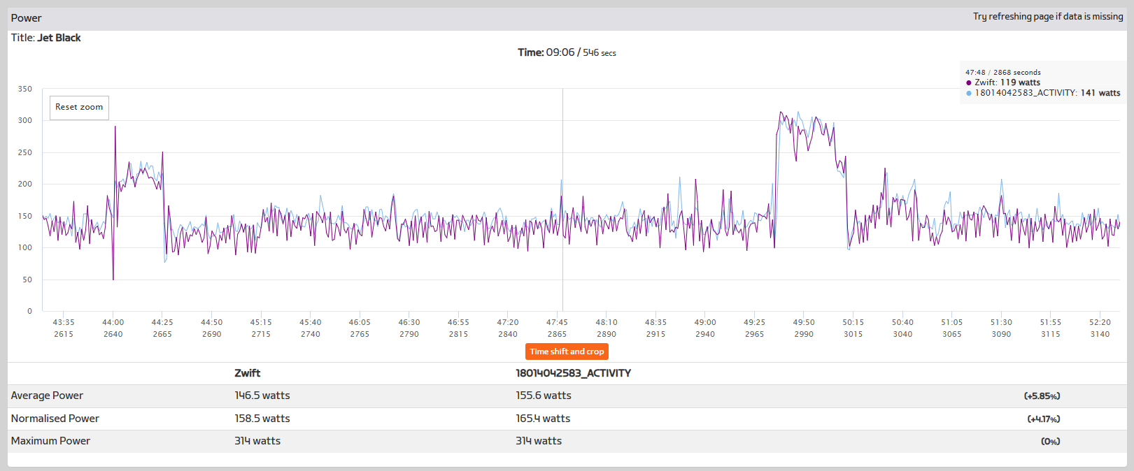

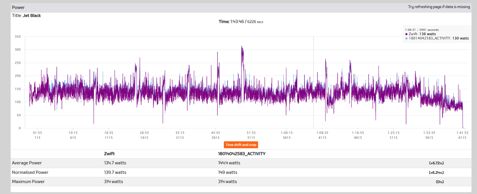

I’ve been using my power meter (Quarq) for power always but tonight I just used the Victory for everything but heart rate. All Bluetooth. No drop out issues in 1.5 hours, so cool.
Only problem now is the power is lower than my Quarq. Dual recording showed the Victory 8% lower at the start and 5-6% lower by the end of the workout. I suppose you could call that the difference between a crank based PM and all the losses recorded through the drivetrain? I dunno.
This was just an endurance ride, so no intervals or anything.
Here’s a zoom on a 5 min section in the middle.
