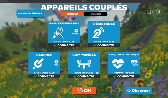

I’d like to report a bug I recently encountered on Zwift. I’m using the following setup: Wahoo Kickr Core paired with the Zwift Ride. All firmware and software updates are installed and up to date.

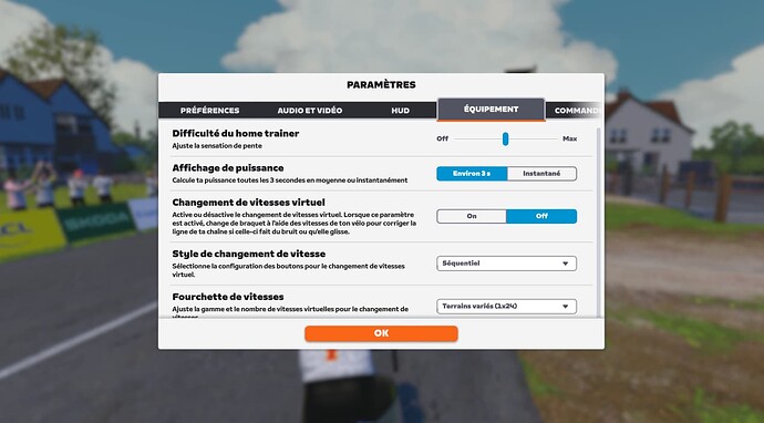

- I disabled the Zwift Ride at the login screen
- And instead enabled the Zwift Click
→ And just like that, the Virtual Shifting ON/OFF toggle appeared in my settings!
I then switched back to the Zwift Ride instead of the Click, and the option disappeared again.
