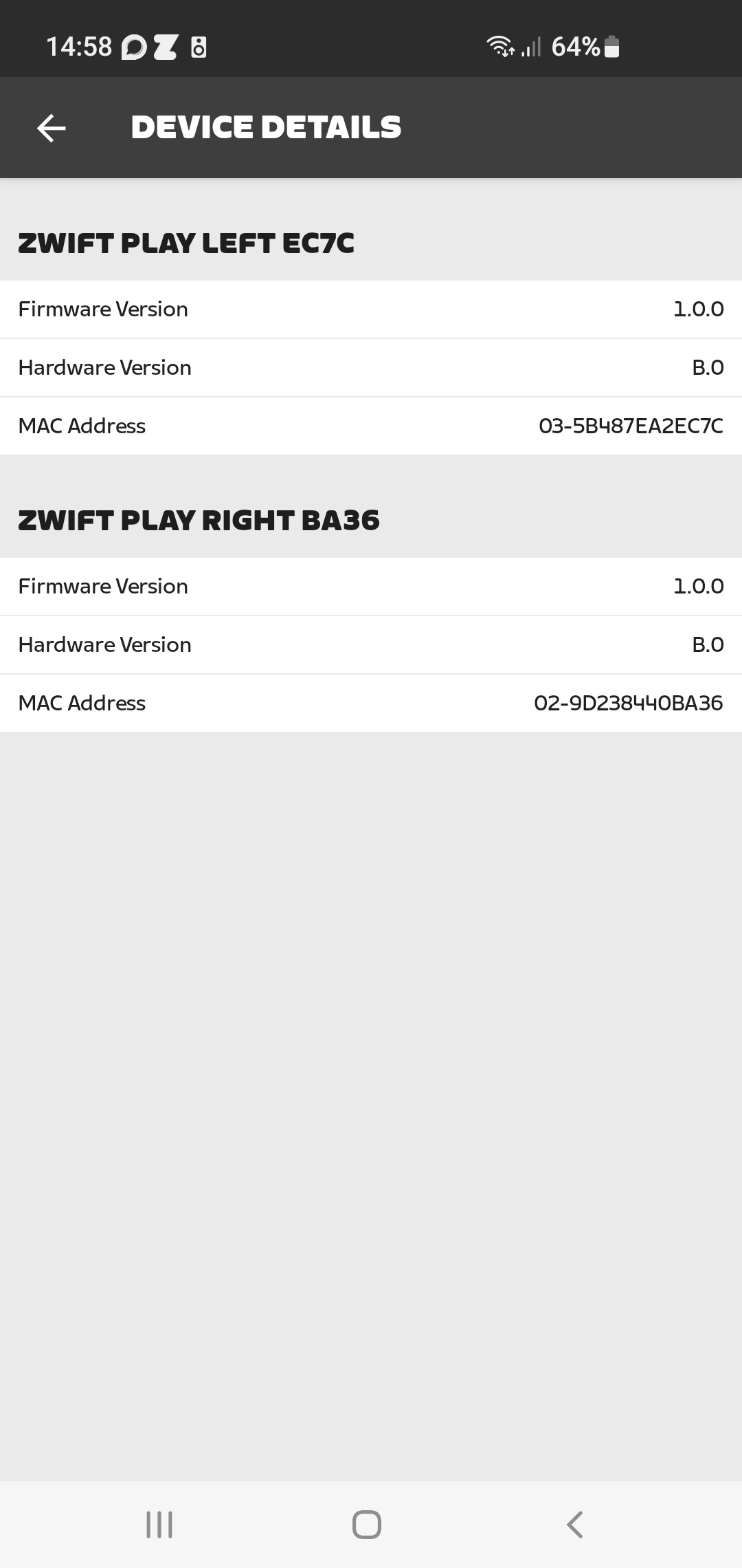

Here’s a screenshot from ZCA. I’m on 1.0.0
I think there may be a slight issue with naming conventions. They’ve probably tweaked the numbers to make 1.0.0 the launch version.

So I guess first question – can anyone confirm they received and have 1.1 installed?
No, it’s not been released just yet. Should be coming soon.
On what version are your controllers currently?
Gang - our most sincere apologies for the confusion. We corrected the forum posts about firmware versions.
  • The latest firmware version for Play is v1.0.0.
  • Version v1.1.0 will be available June 20.
The issue with the Z button and Ride-ons is being worked on, and is separate from either 1.0.0 or 1.1.0 firmware versions. We’ll post an update on the Z button issue as soon as we’re able.
