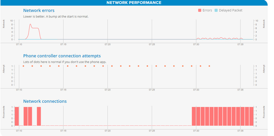

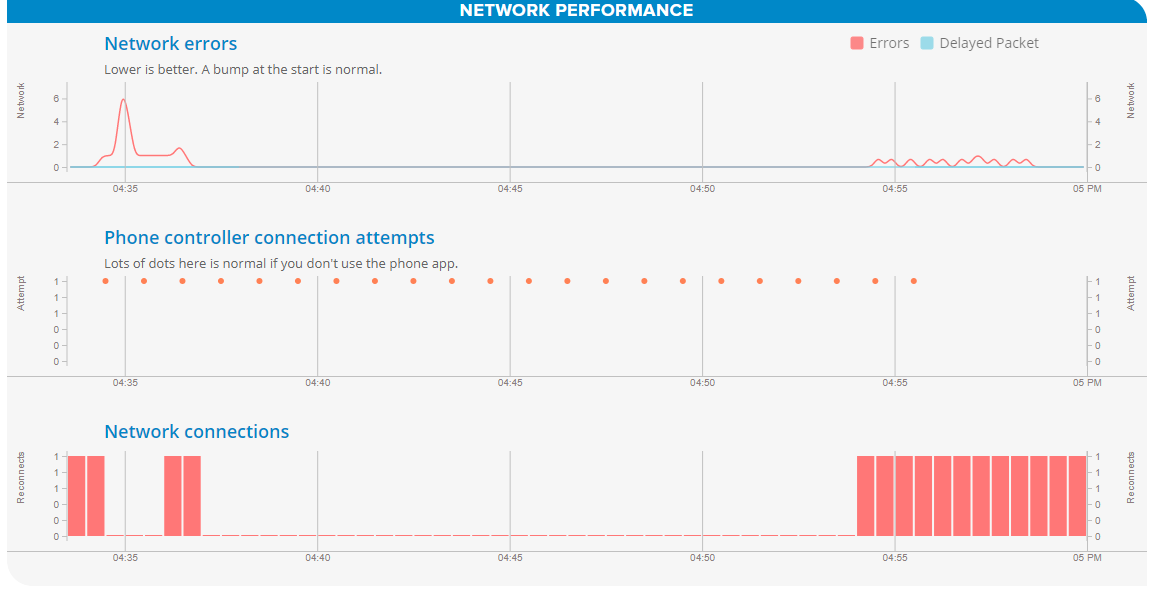

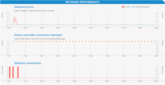

Shuji at Zwift HQ here. Your partial logs get uploaded to our server, and I used zwiftalizer.com to confirm that there is some network disruption happening in the first few minutes. Two of your most recent log files look like this:
I invite you to locate your logs and try it for yourself.
The hard-wired connection is a good move, but as Paul suggested, network disruptions can happen over Ethernet too, and also upstream of your home or ISP. Zwift requires low latency bandwidth because it has to respond very quickly to changes is your power output. It’s not buffering 30+ seconds nor playing back a predictably linear data stream like, say, Spotify or Netlfix.
I too suggest you reboot your modem, followed by the router, and finally your laptop to reset the home network. After these three steps, I’m curious if your log reports improve?

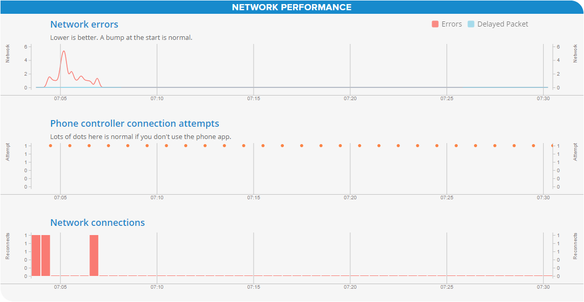

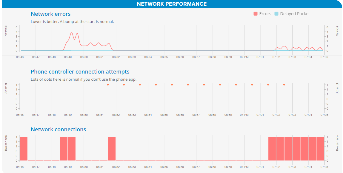

So, first off, the fail logs from a couple of days ago:

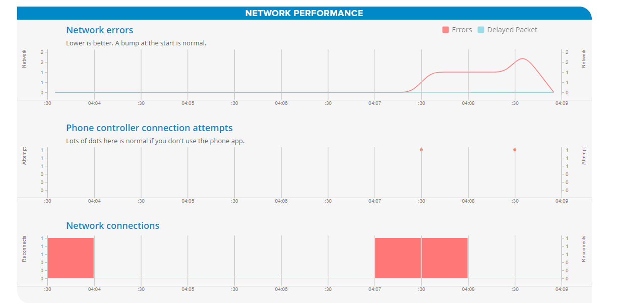

Then the successful one from last night:

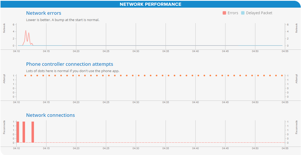

And now today’s:
I was streaming music on that one, and I noticed that there were a couple of attempts to connect to the Companion app around the fail time. I wasn’t using it as such, the phone was in the house and just sitting around, but I went and force-stopped the app anyway while I re-booted everything in the pain cave.

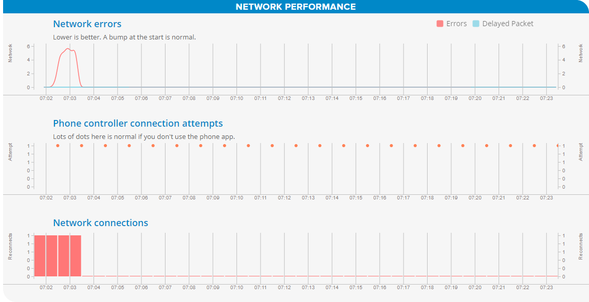

Then 17 minutes into the next ride (no music or anything else streaming):
These don’t mean a lot to me except that things are ok and then they’re not, so any help will be much appreciated! This is sooooo frustrating!
