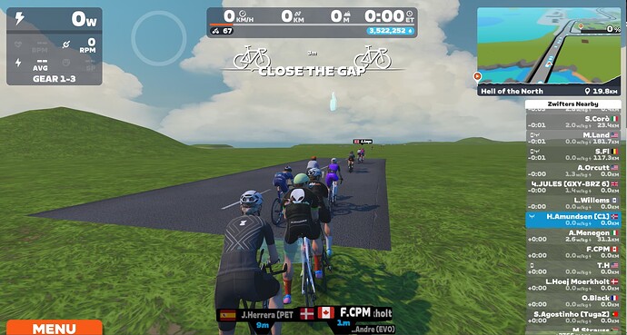

the new “Hell of the north” looks like this when i start the route:
This happens to every route in France after the update 1.87.2
and when i try to join a race (Yesterdays Rhino chase race - Gentil 8) I cant see the pens and no other riders either. Has to be something wrong here. Please help:

We’ve already received reports from users where rocks or grass clip through the road on the Hell of the North route. This might explain what you’re seeing during your rides there. Keep us posted on how it looks with 1.88.0, if the issue is still reproducible.

When in helicopter view some parts of the France map are also missing or overgrown with grass. The riders just disappaired below the grass here.
New CX mode?
