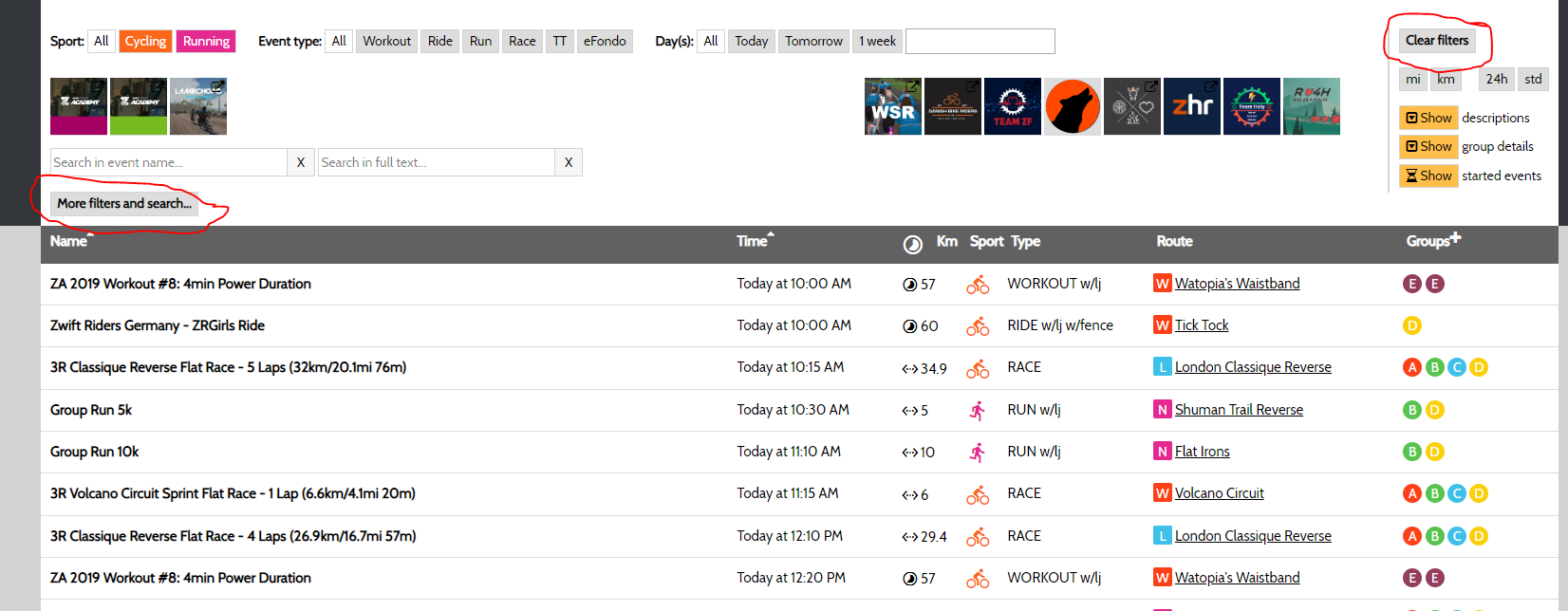

Gerrie’s suggestion to use Zwifthacks provides the info I have been missing but of the 6 fields in my ‘Events’ window, the ‘Time’ column is blank; so not useable! From quick exploration of what Zwifthacks provides, the Events window has a ‘toolbar’ that allows fields to be filtered; that is missing on my window when webpage opened, so I’m unable to ‘trigger’ the data hidden in the ‘Time’ field.

I have circled where to clear filters and how to find more filters.
