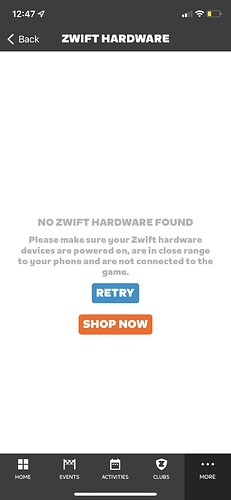

Can't update Zwift Hub firmware in Companion app [Android and iOS]
Hello I have currently the same
issue and already sent an Mail! Is there any other solution then changing the hub? Currently waiting for an response and would love to still be able to take a ride today
Thanks in advance and wish you all a nice weekend
Fabian

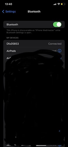

On the phone it seems that my device is recognised under….Dfu… (see photo)

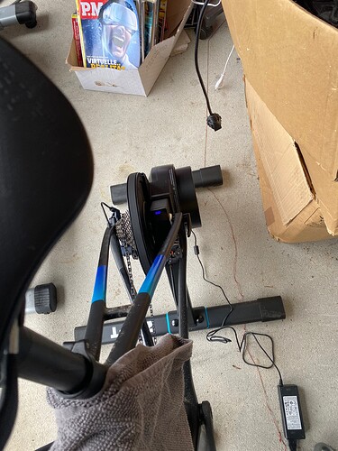

I am setting up my zwift for the first time. Last night, I powered on the Zwift Hub and got a flashing blue light. I successfully paired via Bluetooth, and started the firmware update.
The firmware update randomly stalled in the middle of the process, and since then, the LED light on the Hub is solid red. I have tried to power off/on, even off overnight and on the next day. I have tried on android phone and on Apple TV. The issue I am having is that the Hub is not going into a connective mode (flashing blue light) so I am unable to re-download the firmware update.
What should I try next?

Could try one of the blue tooth apps to see if can see any broadcast from the hub. That utility above would most likely work but would need Zwift Support to send you the firmware as a file to use it. I can’t see anywhere online they are available to just download.
