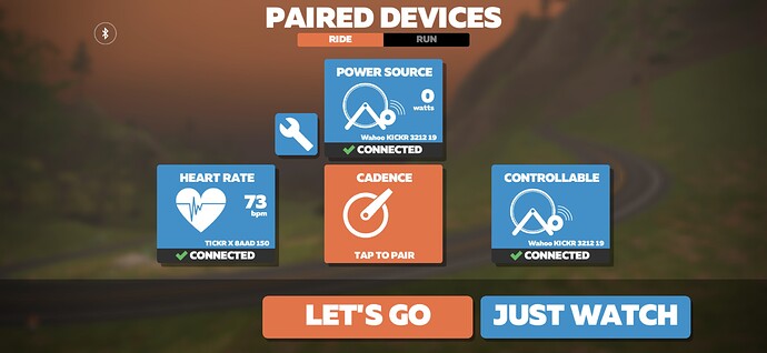

Just gonna drop this temporary solution until this gets fully addressed.
For reference: I use zwift companion to connect everything and using a windows PC for zwift itself.
  1. Unpair your power meter under “power meter”.
  2. Pair your trainer under “power meter”. Then search for your trainer under “smart trainer”. It takes a few seconds to show up in the list.
  3. Unpair your trainer under “power meter” and pair your power meter instead. If you want to use your power meter for cadence, do the same under “cadence”.
I need to do this every time I launch zwift, which is kind of annoying but it works. I think the May update caused this issue and I am surprised they did not address it in the July update.
EDIT: I’ve confirmed that this workaround still works (for me) after the July update.

Sadly, doesn’t work for everyone, for me when you go back to do step 3 it clears the controllable pair.

Support sent me here. But it’s just confirming it’s broken for many. Ios14.6 (and 14.7 that just got realease) on iPhone12 and Apple tv4k. Since 1.15.0 updated for me today. Direct on app Or via the companion app. My Wahoo kicker as a power source/controllable trainer. Or. Assioma pedals as power and cadence. (I use trainer as power/control and pedals as cadence as I have an older kickr
But not both at the same time. So is it a BLE power issue. That the software can’t see both “power” devices at the same time. :frowning:
I contacted support as well, was asked to monitor this thread as you were. Your scenario is a bit different however as you are using the kickr for power and the controllable and the duos just for cadence. I would guess it is something along those lines (BLE) as you suggested. Hoping this gets addressed quickly.
