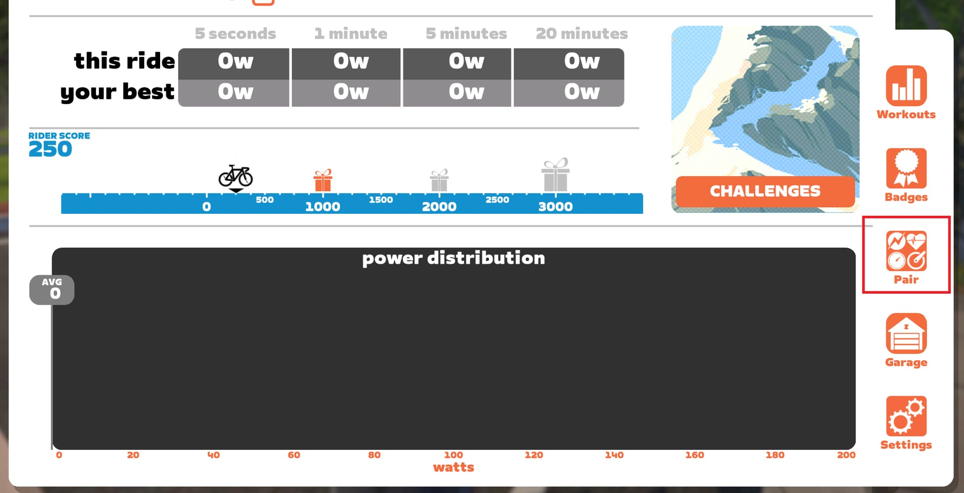

It should appear before the menu screen.
Once at the home screen the pair icon will appear in the top right. See image below.
it’s the left most icon in the upper right section.
You can also access this from riding by hitting menu in the bottom left and pair on the right side
