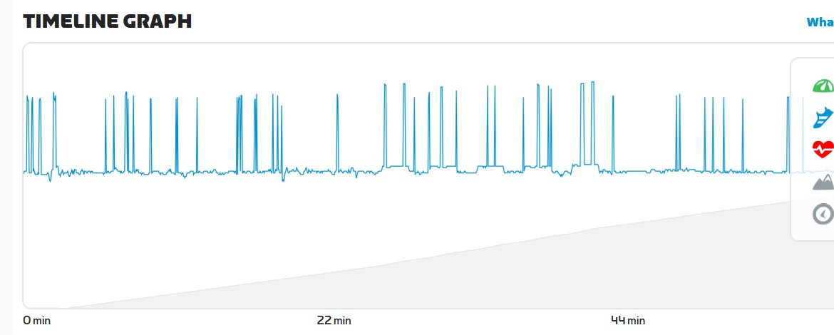

Here’s an image of a run from today to illustrate the problem.
Does anyone else have these issues?
