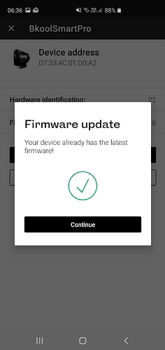

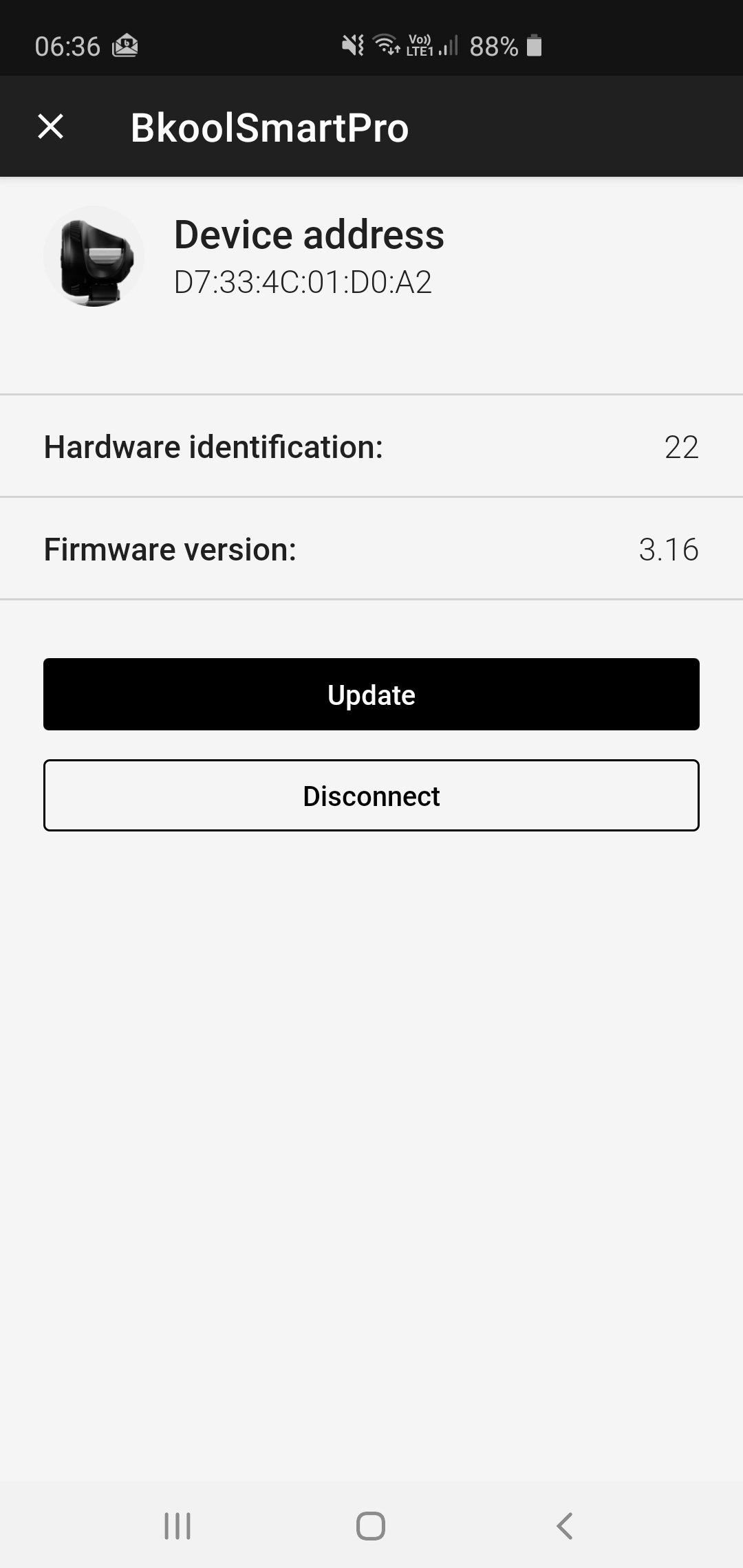

the website says firmware version 3.25 to release the FE-C.
but in the toolkit the latest version of bkool pro black is at 3.16.
What happens if you install the Bkool simulator, is there any option to upgrade the firmware from that?
https://support.bkool.com/hc/en-us/articles/360015866012-Updating-the-trainer-firmware
I’d be interested to know if you get this working as I have a friend with the same problem.
unsuccessfully ! I can’t find bkool pro smart as a controller.
hi, i have the same problem. on bkool toolkit i have 3.16 release, so i tried to upgrade to 3.25 but no result. still in 3.16. 2 days ago there was no problem.

Hi, I have the same problem. In bkool toolkit I have version 3.16, so I tried to update to 3.25 but couldn’t. Bkool tolkit says it is the latest version and does not update to 3.25.
