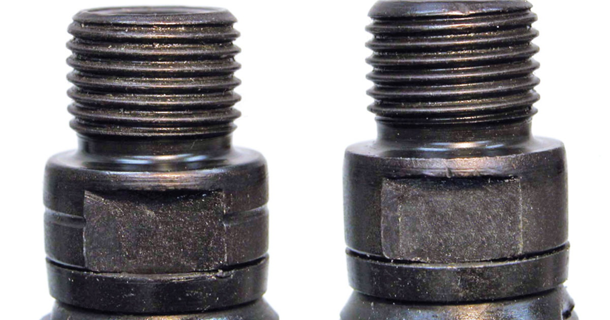

I hope you can help. I have just got my Assimo power pedals and the instructions say to use bike grease on the thread. I have looked around and see that anti sieze is also recommended for pedal threads so could anyone advise on whether grease or anti sieze is best for this?
It’s for an indoor spin bike so it will obviously never be going outside.
I generally grease, or locktite, depending on the use, anything on a bike that has threads. Even down to water bottle bolts. If you’ll want to take it back apart again down the line, put some grease on it (Except, as mentioned, when there’s locktite involved.)
Some grease on both the tread of the crank arm and the pedal…
The ease of removing pedals is more related to how tightly they are put on. You DO NOT need to muscle up when putting the pedals on. Simply nip them up a little beyond the initial tightness.
Typical torque spec on pedals is 40nm. That’s the same as a cassette lock ring, although that’s maybe not helpful because everyone under the sun waaaaaay overtorques cassette lock rings
40nm is putting about 30lbs of effort into a foot long wrench, if that’s helpful.

Park Tool (as always) has some good instructions. Importantly, take care not to cross-thread when you’re installing.

pedals have reverse threads so won’t come undone while pedalling so as long as it feels pretty tight i wouldn’t worry too much about the actual force used.
as for removing. put the crank in the 3 o’clock position hand on the pedal, wrench attached to whichever bit of the pedal needs it (some use allen key in the back of the bolt, some have a bolt like fitting on the spindle) then push down on the pedal and lift up the wrench.
the old push down, lift up is very useful!
to fit pedals, put the spindle in the hole on the crank and slowly rotate the pedals backwards and it will tighten, then finish with a wrench. a good to way to not get confused with which one is reverse threaded!
