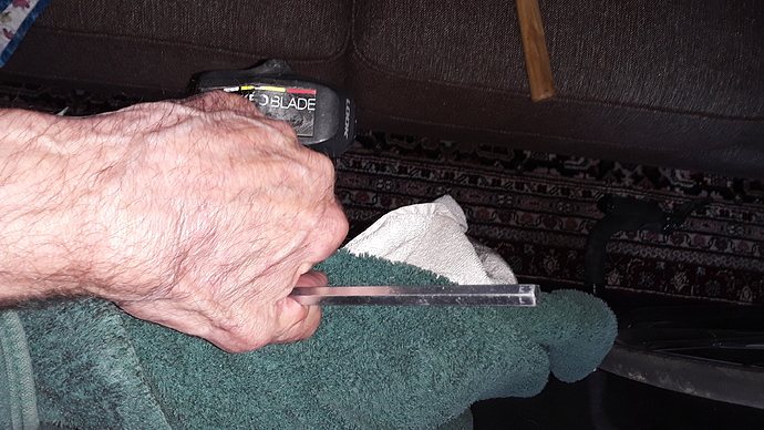

How to Remove Look Pedals without Brute Force or a Bike Stand
Step One: Turn bike upside down on a rug or suitable surface that won’t scratch brake hoods or saddle.
Step Two: Pad the chainwheel; See gory story above. ^^ :boom::sweat_drops:
Step Three: Pad the bottom bracket; you don’t want the end of the hex key to go down and punch a hole in it !! :thinking:
Step Four: Use your non-dominant hand to hold the hex key securely in the pedal socket.
Step Five: Using a rubber mallet, hit the end of the hex key gently.
Step Six: If the pedal is still tight, hit it a bit harder!
Step Seven: If the pedal is still tight, go to Step Six.
Step Eight: When the pedal loosens with a snapping noise, put the mallet down, reverse the wrench and remove pedal. To remove, the wrench should go backward relative to the forward direction of the wheels.
Step Nine: Clean crankarm threads and new pedal threads. Grease pedal threads lightly.
Step Ten: Start pedal with fingers (make sure it’s the proper pedal for the side!)
Step Eleven: Spin pedal in with long arm of wrench. (Wrench turns with forward rolling wheels).
Step Twelve: Reverse wrench and final tighten. 20 or 30 nM is fine; they will tighten further with riding anyway.
Step Thirteen: If the other side still needs to be changed, go to Step One.
Step Fourteen: Ride On !!
If you have Shimano pedals, use a wrench on the flats. No need for padding, but watch out for the chainrings! ^^^ Same turning directions still apply.
