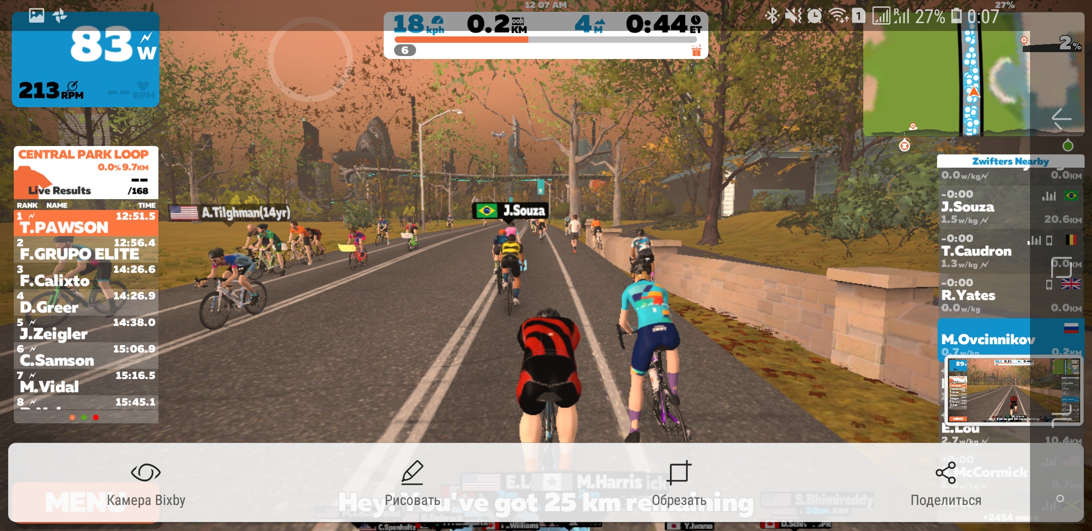

Have exactly the same problem. I’m on android, using Elite Turbo Muin Smart B+. I see the power measuring correct but the speed is always 0.
Now it became even worse - The speed is jumping from 0 to insane numbers. Check out the screen-shots:
This is not the same issue as the OP, you should have started a new thread for this.
As I sad, yesterday and days before, starting from 25th of Jan (after an update) I have the very same issue – avatar was not moving,speed was 0, I opened a support ticket for it, but today the behavior became different.
I don’t know what you said “days before” all I know is what you posted in this thread.
This thread was for someone that their trial ran out and they were seeing power but no speed, your issue isn’t different.
Please start a new thread so we can keep the forum organized and better assist you in resolving your issue.
