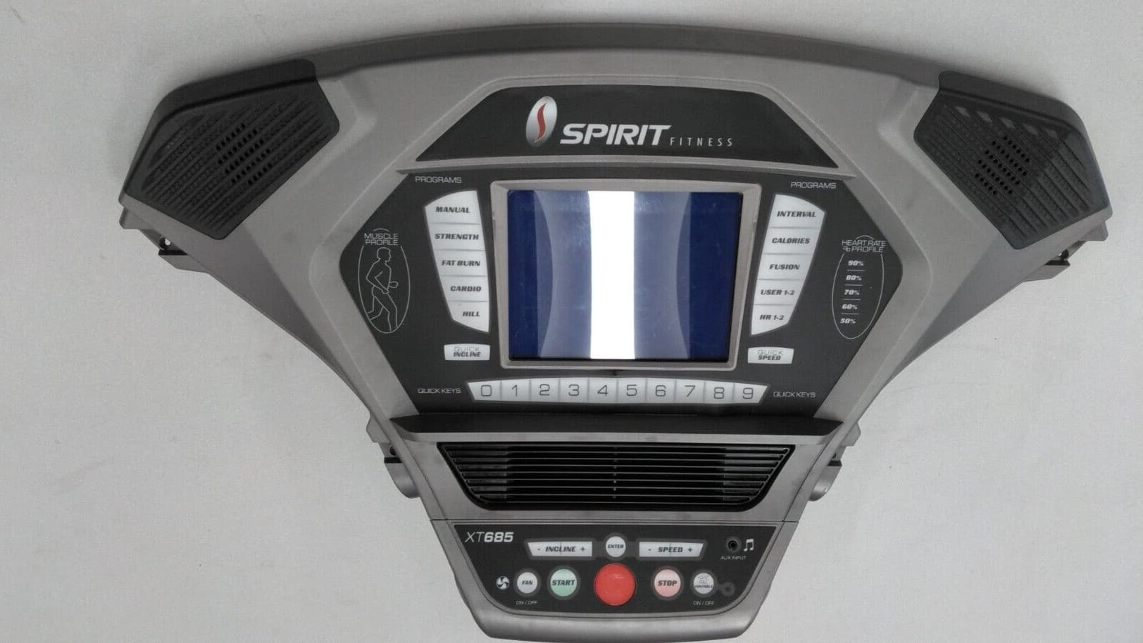

Are you familiar with my console ?
I’m willing to take the chance and I have a solder gun and magnify glass from when I use to mess round with my computers.

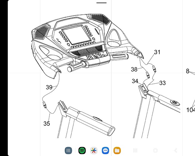

Yes the QZ app will be the same ,but after cutting wires how will we know which type of bluetooth relays to buy { I looked them up and there are so many different types} and where to splice/solder them after cutting the 4 wires ,end of wire or can we splice /solder in middle of wire ,as my wires on handles {not console} are connected in middle of wire.
Your video doesn’t explain this.
I chose the handles and not the console because it is easier to get to.
Yes I have controls for incline and speed on both the console and the handles.
Also ,do I need to cut the 4 wires labeled incline 35 to 39 and 34 to 38 when there are wires labeled computer cables 33 to 31 ?
You sold each button to a relay of this https://amzn.eu/d/781H2va then I will tell you which index is each function so qz know that closing the relay 1 push the speed up of 0.1 and so on
I can’t help you with the wire of this right model, it could be dangerous to do remotely. Please double check them yourself . consider that qz will be in parallel to your buttons.
