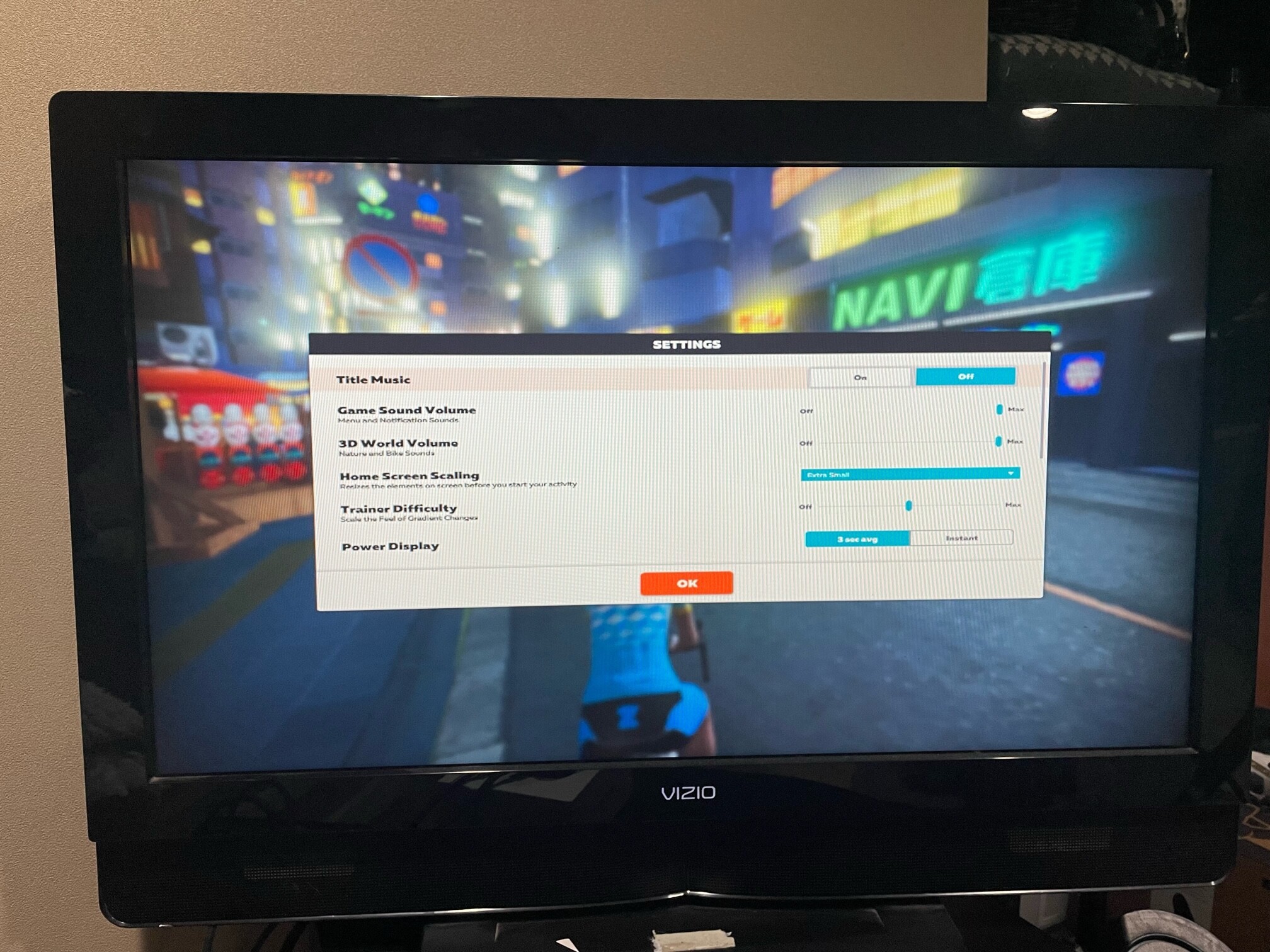

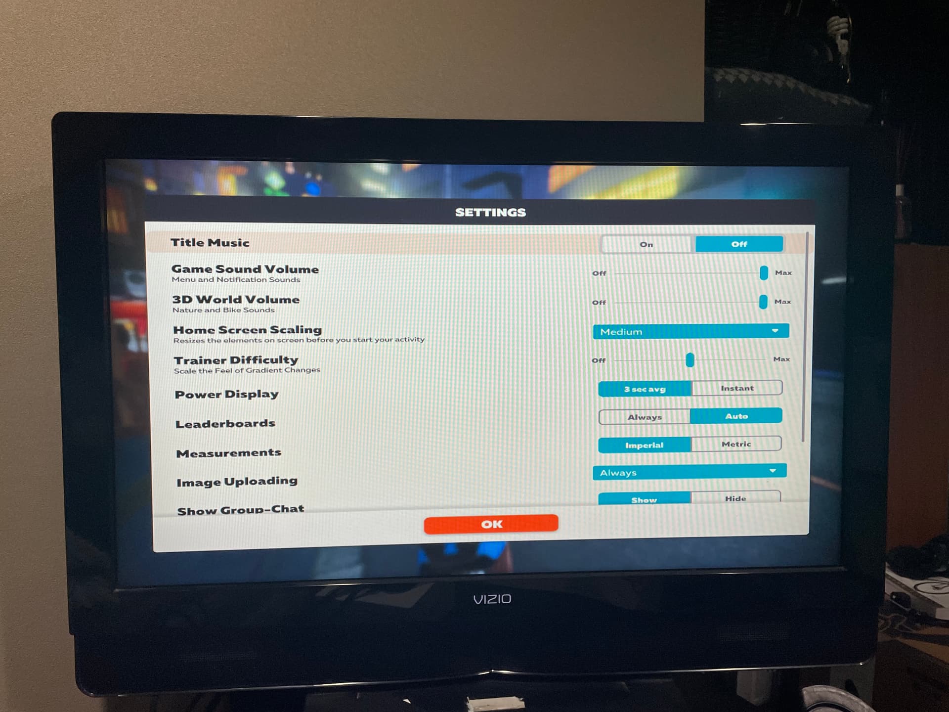

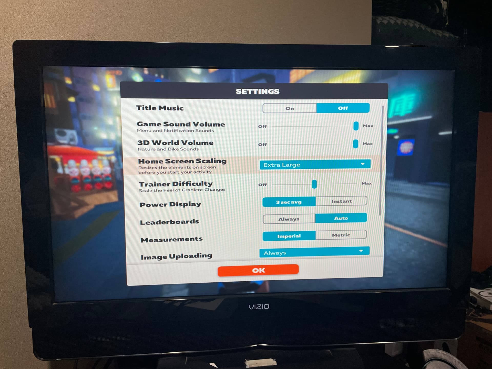

Thanks Shuji. So, I rebooted the ATV, went to the page before I join a world-ride/option 1 and am not seeing an option to go to settings, maybe since some of the graphics are missing? I can get to settings from the Pause screen/option 2 (the icon is still visible/accessible, but nothing is visible/accessible below it). My default is medium and I changed it to extra small and extra large and it only seems to affect the settings page but not the other pages. No matter what scaling setting I am on, the Paused screen does not change. I am also still missing a bunch of graphics on the other screens (riders names, world/route choices, the map in the upper right corner, the effort lines at the bottom if I choose to have them on, the progress bar on the pause page, drop shop icons, my badges are all over the place, etc.). Photos of all screens attached from this effort. I also can’t quit the game from the companion app. As I mentioned before, all of my software is current and I use an iPhone 12 and ATV HD 32GB 1080p model A1625 that I bought in Nov 2020. I guess I am the only person having these issues? I keep trying to reinstall the app or restart the ATV hoping it will fix itself but I am at a loss. Thanks again, should I be calling a tech support line or is this still a good way to communicate? Martina
