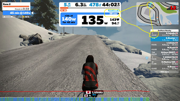

See the attached image for details. I was 58 seconds from the end of a workout interval. The end-of-interval circle is displayed in the minimap. That circle is quite accurately positioned. Also displayed in the minimap is the position of the rider ahead of me (R. Jajodia). Note that R. Jajodia has already passed my end-of-interval circle. This means that R. Jajodia is more than 58 seconds ahead of me. Yet, on the “Zwifters Nearby” list, R. Jajodia is reported as being only 19 seconds ahead of me. That’s just not possible. Even though R. Jajodia is stationary, I can only reach them in 19 seconds if I speed up to three times my current velocity.
I’ve circled the relevant parts of the image in yellow.

I noticed the issue in situation similar to Siobhán. Doing a workout around Tick-Tock, the arch appeared on the map a minute up the road, with the nearest rider beyond that point. The Zwifters Nearby gap told me that I was only 15 seconds behind. So it doesn’t appear to be any more accurate on a nearly perfectly flat course.

It’s quite possible that I just don’t understand the lead/lag times reported here. It may have been a conscious design decision not to tie them to a particular rider’s effort, so that they don’t go up and down as your power output changes. For instance, you wouldn’t want the lead times to go to infinity if you stopped. Maybe these times are calculated assuming a constant 6 w/kg? I’d be curious to hear from someone who actually works for Zwift and knows the answer.
