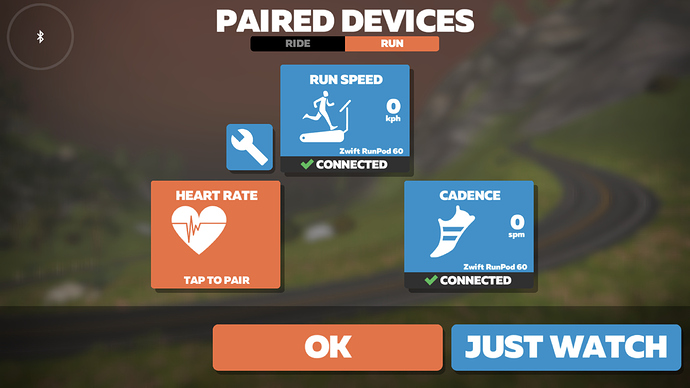

Hi Paul,
I can connect the ZwiftPod
The I Dont get the ”Run” option. I press ”OK”
[image|690x388(upload://iaXwtIn5pFYQ7RT6Qr60ItndBbG.jpeg)
How should I start? I dont know what known big Zwift support alluded to.
After my workout there was no activity recorded - ie sofar only 1 after 5 attempts.
I use it on iPhone with latest App and iOS.

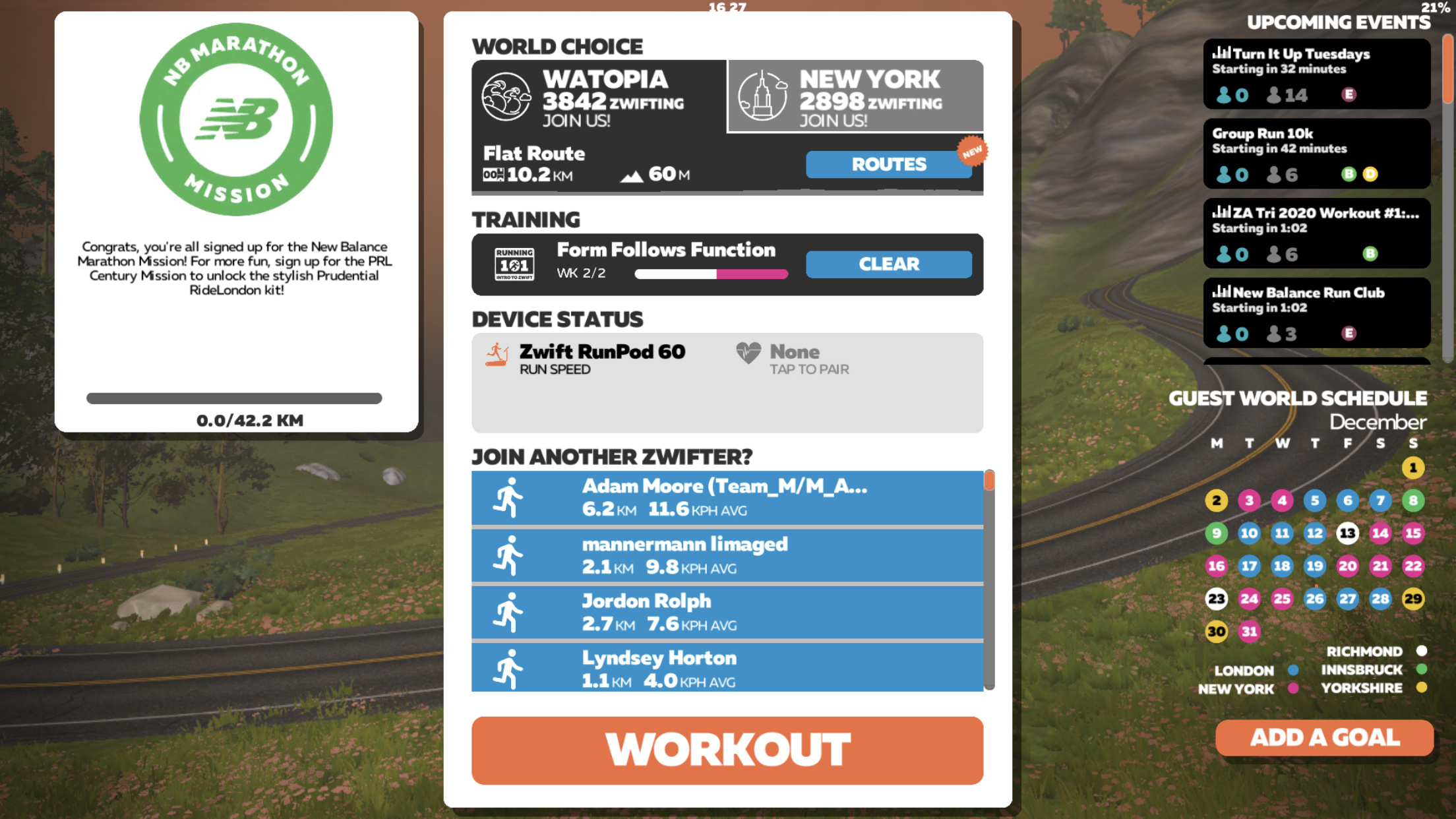

How long was the workout (in distance and time)?
Did you click on the wrench symbol?
If you want to “Just Run” clear the training plan.
Workout was 6 k / ca 3,8 Miles - 45 min
Have tried to push the Wrench button before, did so Find anything useful… what should I look for?
I’d love to just Run - I Will try to clear the training plan, thought it was a necessary component…
That run was not done in Zwift, to get it to show on Zwift you need to use the Zwift app.
If you want to use the Milestone Pod while running you can use other apps besides Zwift.
Within the wrench symbol you can calibrate the pod and check for firmware.
Hi Paul,
That is the issue: I’m not able to get the Zwift app started… the wrench guidance helped me.
Now it did Ask me for an update (to 4.0.52) - had not earlier prompter.
Did that. Next it Ask me to calibrate… I dont have a treadmill… what Do I Do next? I know I Ran 5 k at 27:45 recently and that was ca 4100 steps.
The Zwift App is meant to be used on a treadmill (just talking the running side here). Without a treadmill you cannot calibrate it within the Zwift app. The Zwift app is not designed to be used outside.
You can run in Zwift without calibrating, but it will not be accurate.
Do you plan on running on a treadmill or outside (or both)? If you are just going to be running outside I would suggest connecting the ZwiftPod to another running app and only using the Zwift App to keep the firmware updated.
Amazing - I got the ”Run” to the screen… because the ”Workout” and ”view entire plan” reacted for the first time!
