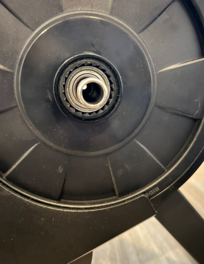

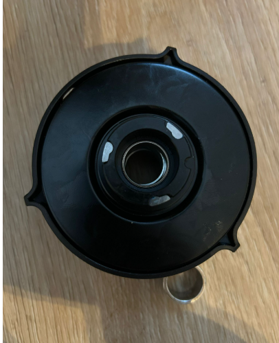

Hi,today i receive my cog v2 (multitrainer)with click to put in my zwift hub,unfortunately i can’t install it .I made everything i see in zwift video but no,it can’t install it.I looked in the compatibility before i bought it and i saw that multitrainer was the best choice.Any idea?I send a email with that problem,thx
Hello ! Send a picture of your cog. If you have a freehub body inside the cog it should work.
Thx for your response…tell me if you can
hello,I solved the problem I had in a simple way, which certainly shouldn’t have been done like this, because I did exactly what it said in zwift video, so what did I do, with a small screwdriver I pressed a pair of the 3 small hooks that the cog has and it clicked immediately without any problem, the video certainly doesn’t show anything like that but it says just push in and rotate until it clicks, whatever it is, everything is fine…thanks :slightly_smiling_face:
This ended up working for me! I just went around to all 3 spines and gently pushed them in one at a time while putting light pressure on the cog until it slipped in and fit. And just for reference, I have the original Zwift hub and replaced the cassette with the cog v2.
