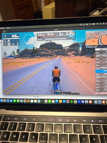

Very new to Zwift–Just setup my Apollo bike on a Blackburn Trackstand, with a speed sensor on the back hub, and a cadence sensor on my left crank arm. I don’t seem to be translating the same speed in-game to the output I am putting in real life (see below brief stint). I feel like I am working my a** off in real life, and Zwift has me going at 3mph-9mph. I have tried switching gears on my bike for more resistance and the resistance on my trackstand to the most to see if that would affect anything and it doesn’t. I am very new to biking, but I know I should be producing way more input in the software than I am in real life. That 63watts is on max resistance on my bike and trackstand, so I know it should be more. For reference, I run a kilometre in roughly 5.30 minutes, so there’s no way the output I am giving to this bike is accurate, as I know I am working way harder than it is displaying. any suggestions or troubleshooting?
UPDATE: When I am in the menu (where you pair censors, controls, etc.) my speed sensor is displaying speeds up to 25mph in the same situation, with the cadence sensor displaying roughly 65rpm. Why is the game showing just a fraction of that input?
this information is being dispalyed on an FTP test within Zwift, and I think at this exact scenario, there is only 13ft of elevation which doesn’t seem like a lot…

Please below three screens when I am putting out a very strenuous exercise when it doesn’t seem like I should be working this hard:

In the screenshot you have provided you are going seriously uphill on the Hilly Route, that will seriously reduce your trainer wheel speed to the in game speed. When testing your system please select Tempus Fugit route, that will give you a closer correlation.
