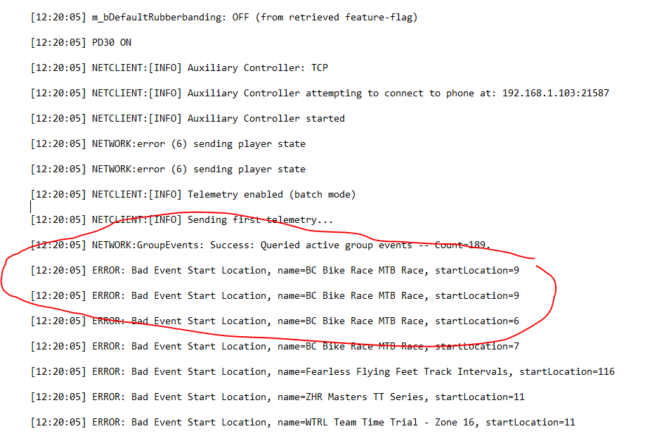

Hi I am constantly having Zwift freezing at some point when joining event only
Seems to be ok when free riding in watopia or richmond…
My laptop is a Lenovo s145 i5 windows 10
It is only wi-fi but am super close to router and no issue, other then when on zwift
I have included the log file when it failed last as well
Put your logfile into https://zwiftalizer.com/

Ok I have done this but how do i interpret what this issue is
You do seem to be having some ANT+ issues. Can you move the AMT+ dongle closer to the trainer, e.g. via an extension cable?
But I doubt that’s causing the freezing that you’re seeing. How about the network side in those stats?
Also, which CPU do you have exactly? You should be able to find out via Settings, System.

10th gen Intel (which you have) has known freezing issues with Zwift. Try this workaround - Zwift Crashing/Freezing Mid ride - #378 by Peter_Gross
Cool thanks, looks like that could be the fix I have just completed the update & will do a lunchtime cycle today & advise
Thanks Steve you’ve been super helpful Kudos to you mate!!
Well, Did my cycling race test and no freezing, Thanks Steve!
I did also connect via blue-tooth my smart trainer but I`m confident i have tried that before and still failed
The driver update seems to have fixed it
