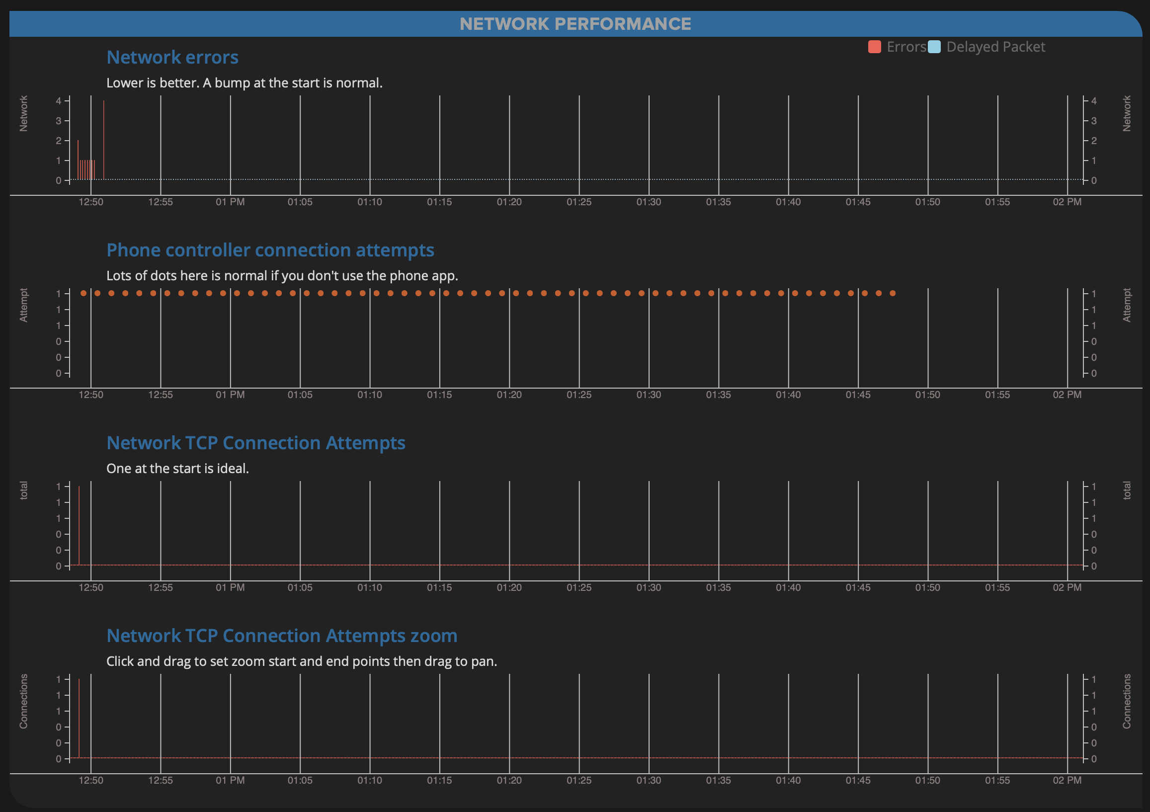

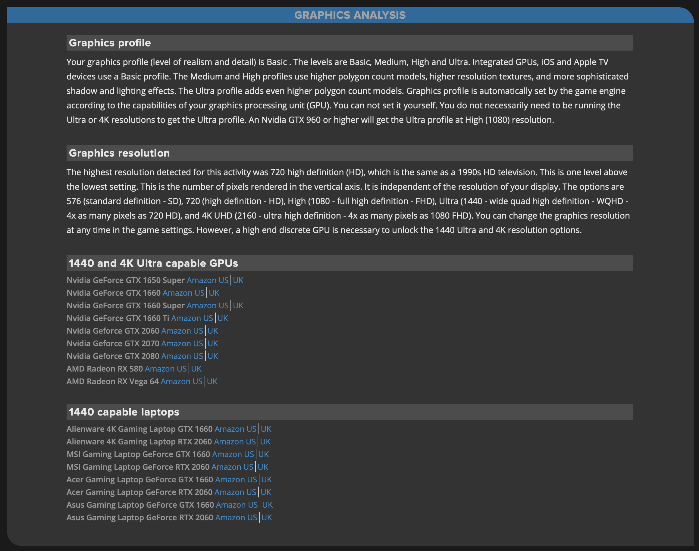

PS. I looked at the log file in Zwiftalizer but I don’t know what I’m looking for or what any of the info means so not sure if that would help figure out my issue.
Here are the Zwiftalizer images from my ride today:
You’ve got Intel integrated graphics,so unfortunately it’s probably the widespread problem on this type of setup that Zwift are trying to track down at the moment.

You’ll see that a lot of people have been having similar problems. And you do have the integrated Intel graphics that seem to be common to so many of these reports.
If it is that problem then I’m afraid that until Zwift fix it, then the only thing you can do is try running it on a different client device, e.g. a different PC/Mac, an iPad, phone, Apple TV.
