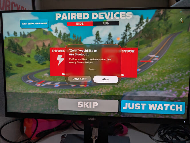

Shuji at Zwift HQ here. Please try uninstalling the main Zwift app from your Apple TV, and re-install. Here’s why: I am peeking at your server logs for clues. Back in March, your Apple TV box was running tvOS 18.3.0. Today, it is running tvOS 18.6.0. Apple resets per-app permissions back to a stricter default security setting whenever they update your OS version. Stripping the app’s Bluetooth permissions will result. The simplest way to fix it is to re-install.
When you get to this Pairing Screen prompt, say yes to the prompt asking you for permissions to use Bluetooth
Select the Pair Through Phone button to the top left of the screen if you want to use Zwift Companion to bridge.
Give that a try please? Also - the latest version of tvOS is v26.1, so you may want to update to that first so you don’t have to repeat the steps above.
