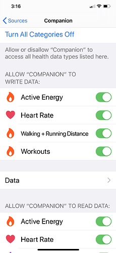

On my iPhone 11 Pro Max under the system Settings>Health>Data Access & Devices the Companion app doesn’t even show up as an option to select so I can’t get to a screen like the one you showed in your post. This is very odd…

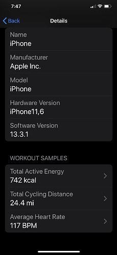

That is. Maybe delete the app, reboot your iPhone and reinstall Companion app. It should ask for permissions again. Distance is written for me. In settings, health, Companion, Data, Workouts, I have all my workouts. When I tap one, I get this:
Top:
Scrolled down (distance):

Yes, distance is captured as part of the “workout” but not written to the “cycling distance” data element that Brad is looking for given he doesn’t use Strava or any 3rd party product to keep a running total of his cycling miles. Bottom line the way I see it - the Zwift Companion app is not currently programmed to write to this data element in Health and is not a bug; just a feature request.
Mine looked just like this in Settings and obviously no option to select anything to get sync’d to Health. After uninstalling, rebooting, and reinstalling Companion now this doesn’t show up. Companion doesn’t show up at all.
