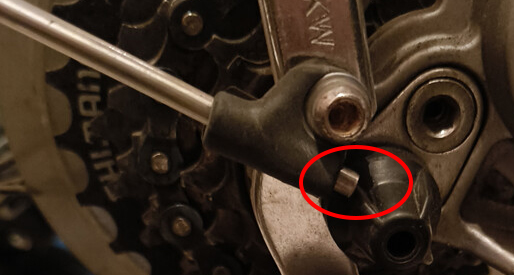

There is quick release mechanism with 135 mm axle. I am attaching the photos of the solution.

Side note - It looks like you might have a fender on that rear wheel? This part here is the end of the fender strut.
It looks like the end of the strut sticks out past its clamp enough that it might interfere with the nut of the quick release skewer? Hard to tell from this angle, but it may also interfere with the QR on the trainer. You can loosen the clamping bolt above it, move that strut a few millimeters, and re-tighten the bolt.

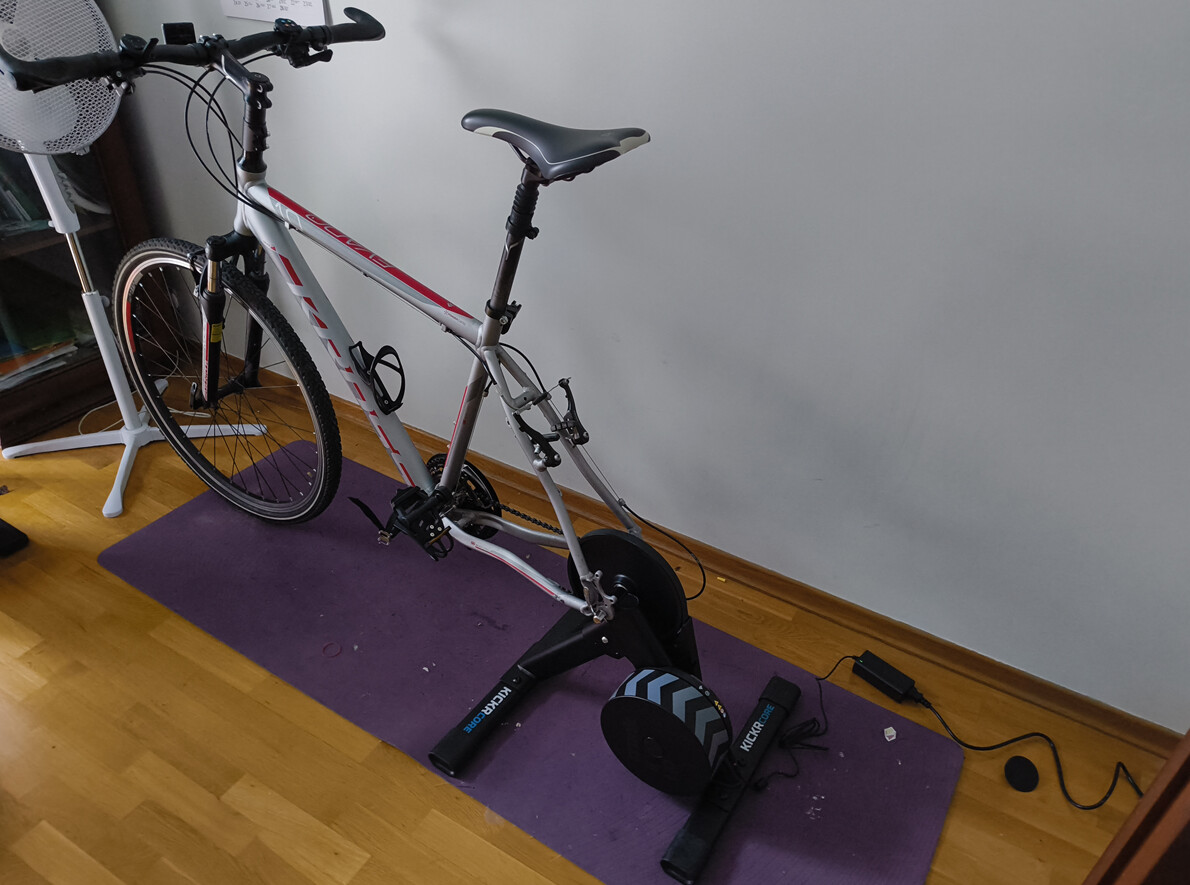

Hello again @shooj ,
It’s been several days since I made my set up with Kickr. 7,3 mm chain works just fine, besides precise cleaning and regreasing, I have not made anything with it.
I have disasssembled the fender and used QR delivered with trainer. 7-gear drive does not make any issues so far, it works fine with Cog. I am happy with the final result mainly due to the fact that I could use my old bicycle for the job. Thanks for the support. See you during workouts.
