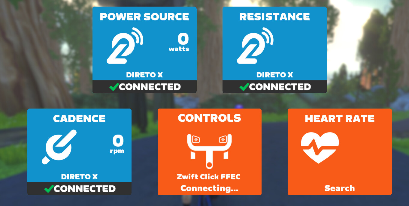

Just received my new Cog & Click v2, everything works properly when using Zwift Companion as a bridge, but when trying to connect the Click directly to my computer I’m stuck on this :
And it won’t connect

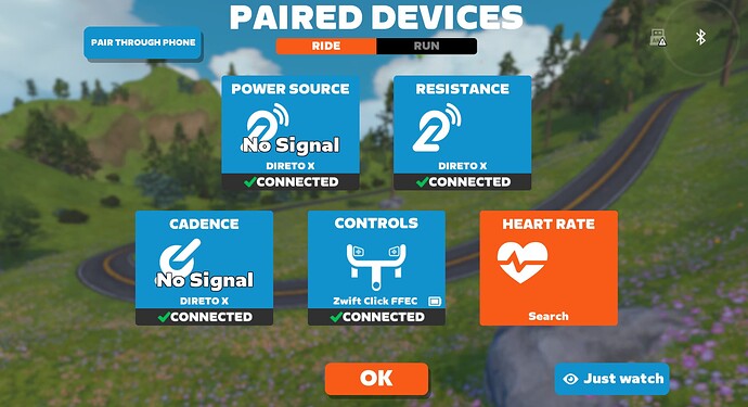

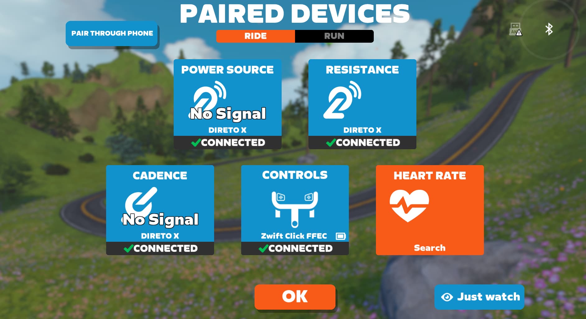

Can’t tell what is the fix and what caused this bug, but gave it another try this morning just to check and this happened :
EDIT : Still bugged because they went idle and I have the same issue as in #1
