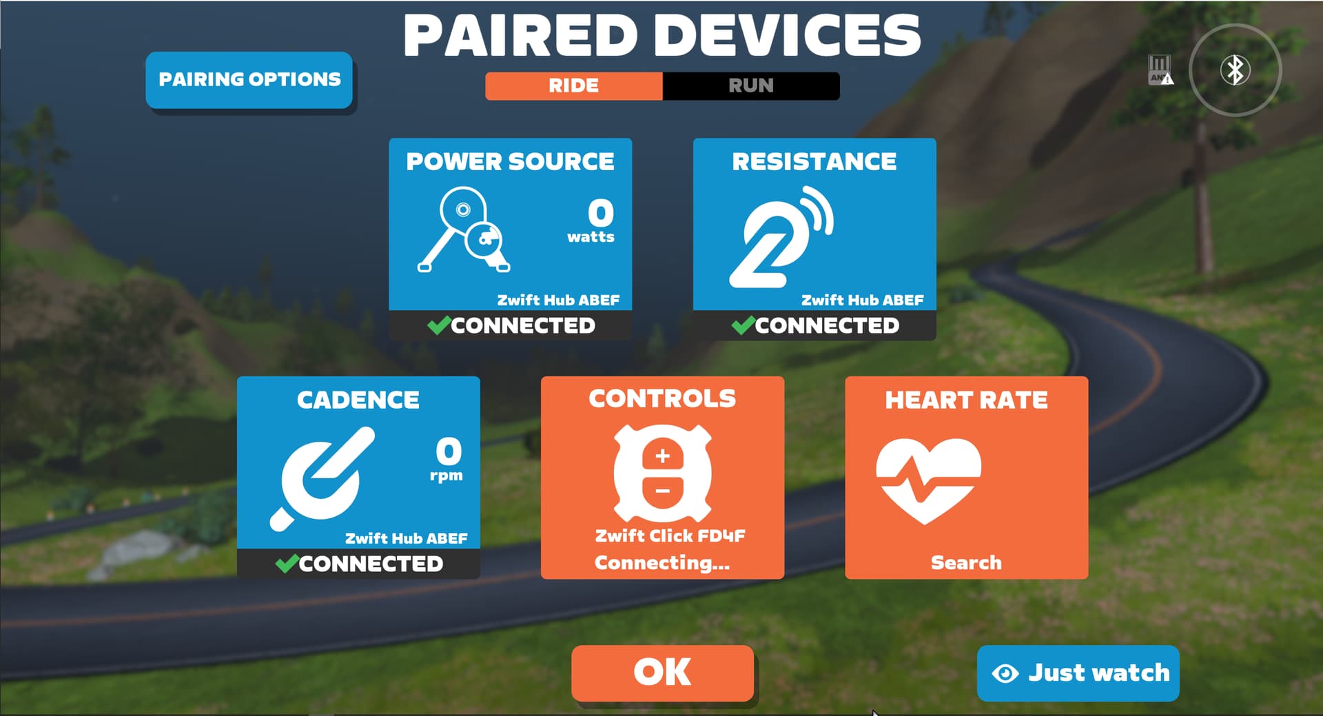

When you are trying to pair to the Click - are you seeing the Connecting... icon hanging like this?
Exit Zwift by saving and closing your open session (or trashing and closing).
Open Windows Explorer, and go to the Documents\Zwift folder.
Delete the knowndevices.xml file. This is the list of the devices that Zwift has paired to in the past, including if those devices were paired over Bluetooth or ANT. Deleting the file is like starting fresh.
