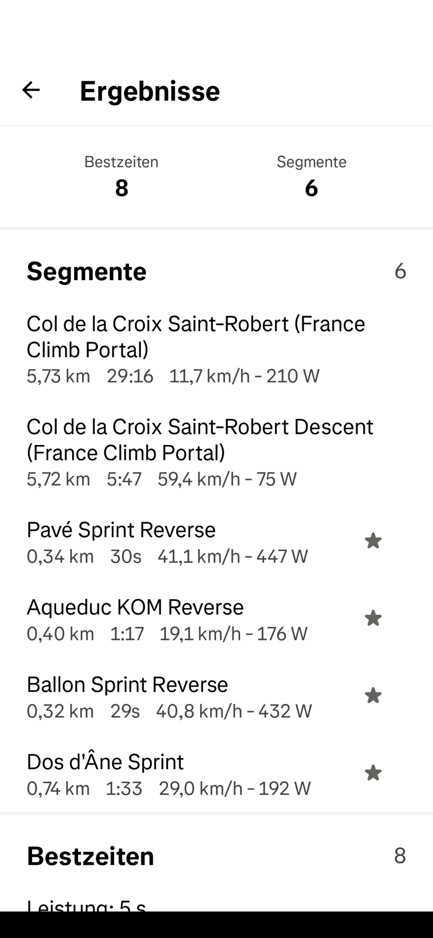

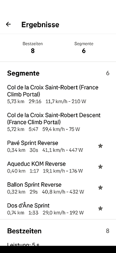

I’m assuming Strava may hold those numbers; but… I don’t have or do Strava, so I can’t confirm.
Yes, it does - but the Strava segment is the whole climb, not the segments Zwift is showing.
