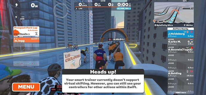

I have the Tacx Neo 2T and just purchased a zwift frame. I thought with the recent announcement that virtual shifting working work Tacx Neo 2T. I just got it home and all hooked up and it’s saying virtual shifting isn’t compatible. Do I need to buy the cog and click? That seems like a waste if it has to be taped to the handlebars and doesn’t work with the integrated shifters.

@Jose_M2049 thank you for responding. I uninstalled and re-installed and am still getting the “not compatible” message. I’ve also tried connecting on my PC and on AppleTV. Appreciate any help so I can get riding! I have not been contacted by one of your colleagues yet.
Do you see firmware 2.6.0 in the Tacx app?
You have to install the TACX Training app in your phone. Open the app and connect the NEO 2T to the app then you will be prompted to update the firmware in your NEO 2T. Update the firmware, disconnect the NEO 2T from the TACX Training app, open Zwift, connect the NEO 2T to Zwift over Bluetooth and then enable virtual shifting going to Settings/Hardware.
@enricoclaudio Thank you! Rookie move, I guess. I never disconnected the trainer from the Tacx app. I’ve been fiddling with it all day! It’s working now! I appreciate you breaking down each step for me. Have a great weekend.

Hello, I also struggle to get the Neo 2t to work with Zwift click and cog. Both have latest firmware and they are disconnected from the Tacx app, but still it states that my trainer is not compatible. I’ve reinstalled both Zwift and Tacx, and tried on my computer
Any chance you have an ANT+ adapter in your system? If so, pull it out and try again.
No, I’ve tried both on my Iphone and PC and no ANT+ attached to neither
