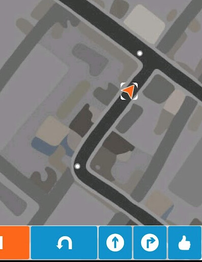

Left/Right at a junction - working as intended - can select either left/right on the companion app and have that work.
(Left/Straight on) or (Straight on/Right) - broken - can select only the left/right option, with straight on not being selected in game if you press it on the CA (hitting left/right arrows on a keyboard works).
Richmond. Specifically this junction here:
will provide you with 2 buttons on the companion app (which two depends on what the current selected direction is)
As “expected”, clicking the “straight on” arrow won’t select the “Main Loop” option; but pressing the Right arrow in the CA will select that route along with changing the buttons on the CA to reflect the available choices here (another press of right on the CA will then select “Reverse Climbs” - doing the reverse at this point also works, with pressing left selecting “Main Loop” and then “Reverse Loop”):
