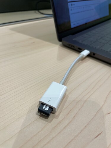

I just did that successfully. I have a Garmin ANT+ stick and an apple adaptor. I found that by inserting the ANT+ usb stick into the apple adapter and then pulling it out by about 1mm the connection was made. I’ve found this to be the case with SD cards in the built in slot and tried it here and it worked.
