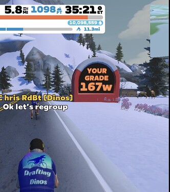

In group ride last night I saw this, around 30w below my FTP. I would guess that 167w figure was the average of my effort and no %age ‘FTP’ calculation has been applied to it?
Edit: Intervals had me at 172w for The Grade segment.
You are right that the history should be available, but right now you can contact support and they can provide you with your FTP history. They have the data, they just don’t show it to you.
