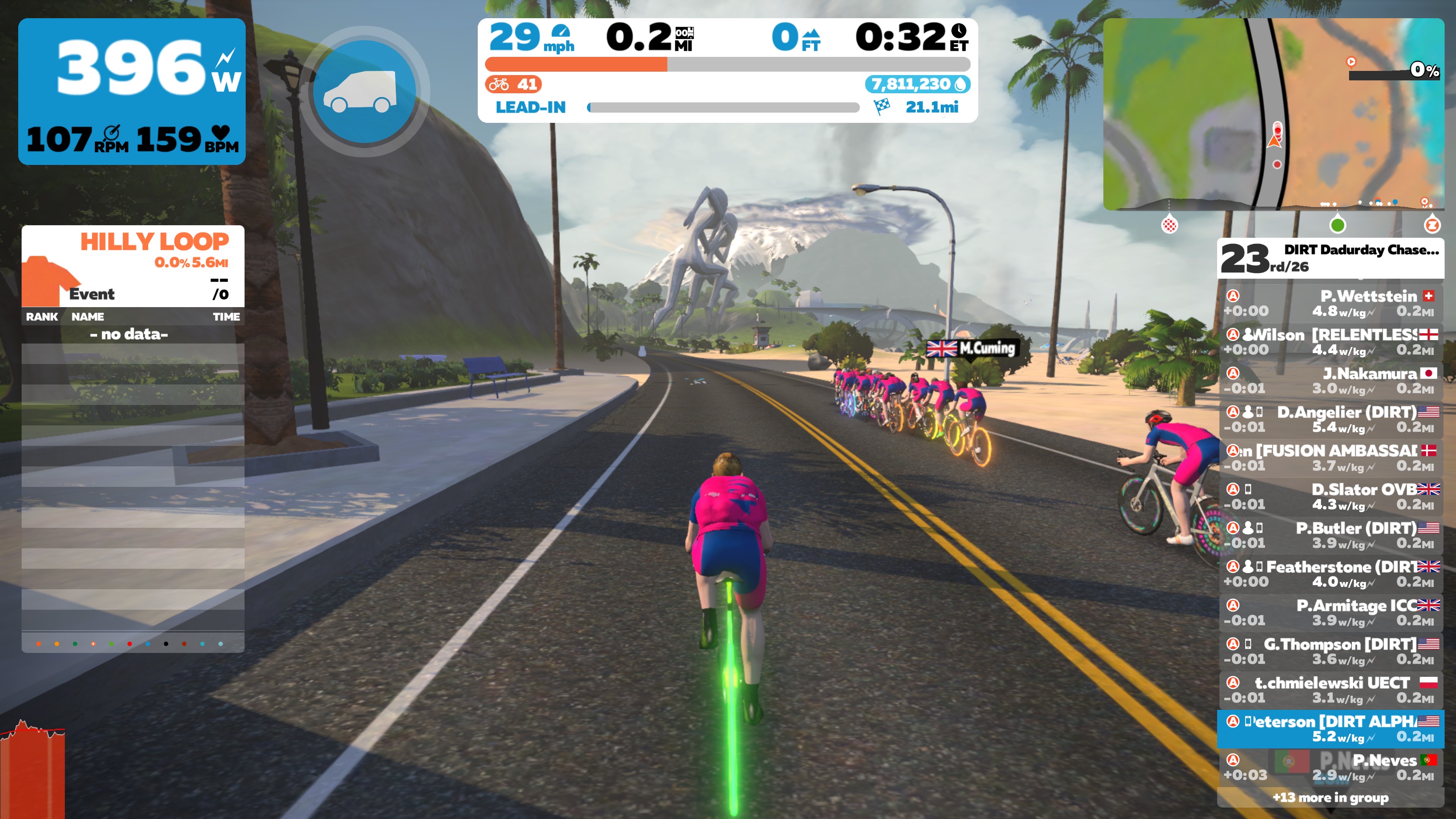

Got my Sterzo last night. I use Apple TV to run zwift so I used the companion app to connect 3 Bluetooth devices (trainer H2, heart rate, and Sterzo).
I began to warm up in free ride this morning and everything was fine. Steering worked, etc. I then joined a race (DIRT DADurday at 7am EST). When the race first started my avatar was immediately moved to the far left hand side of the road (not just lane, entire road). My avatar continued here, out of the draft, and never move back into the blob.
I quickly stopped that event and joined the next race. When I got to the pen, all the riders were missing colors. Additionally, when the race started my avatar just sat in the pen, despite the watts being produced.
I may have bugs with multiple things here - steering and maybe using the companion app as a bridge?
I have attached a picture of the start of the DADurday race, with my avatar over to the side.
