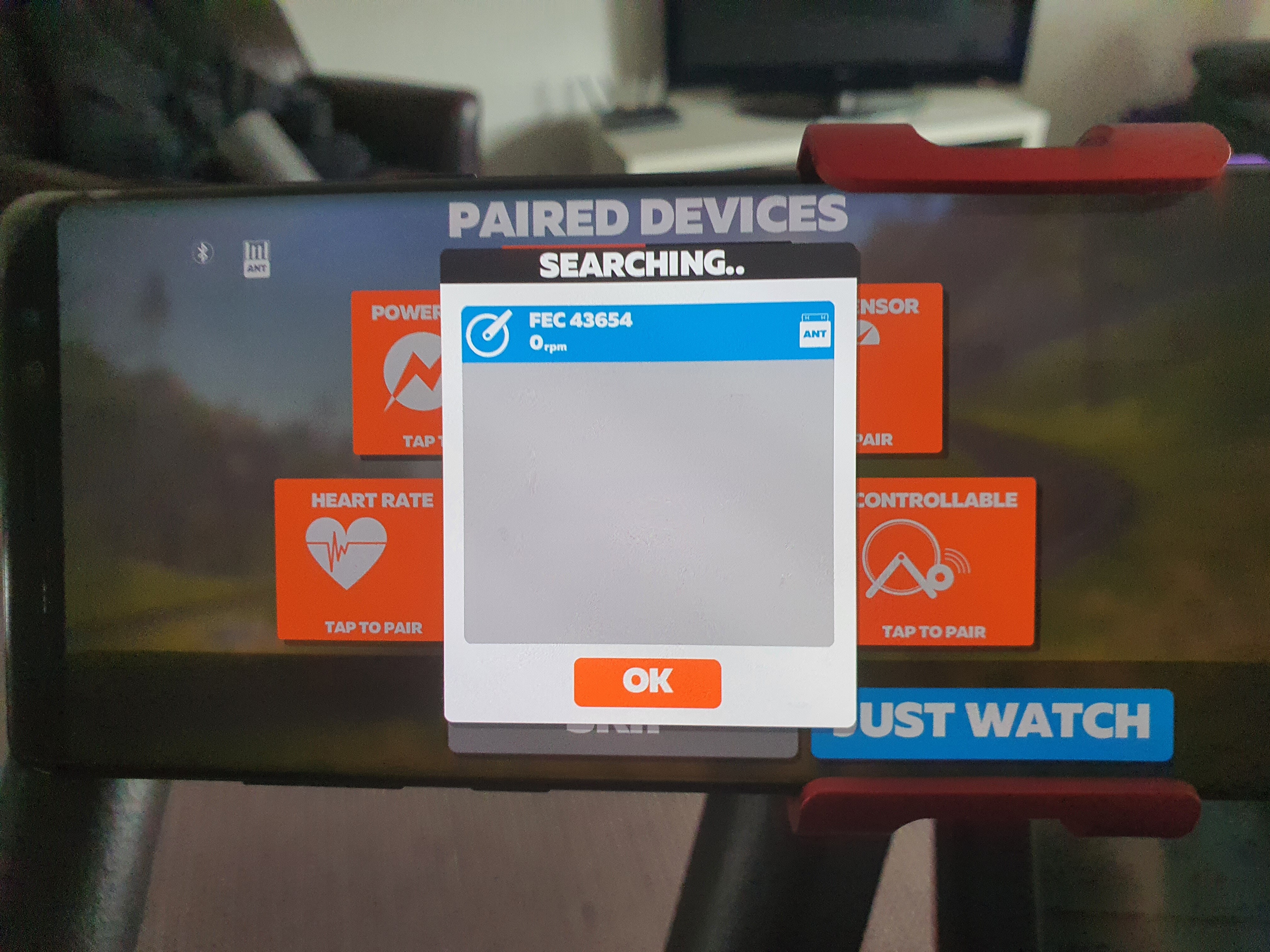

  • I pair the power meter on the splash screen that appears after touching on my name on Zwift on Android
  • my meter appears as an option under cadence (but always registers 0 here)

Hi again. It is picking up the FE-C profile and I’m selecting it. I’ve attached some photos, you can see in all cases it includes “FEC“ or FE-C” in the name of the transmitting device, and I select these.
Also:
  • thisisant says the device supports 4 profiles including FE-C (thisisant com directory mpower-echelon2-cosole)
  • The manual says that the device uses the “ANT+ Fitness Profile”
  • Interestingly on wakeup the name is transmitted as “FEC 43654” but after a minute or so the name changes to “STAR TRAC FE-C 43654”
Thanks for your interest and help.
