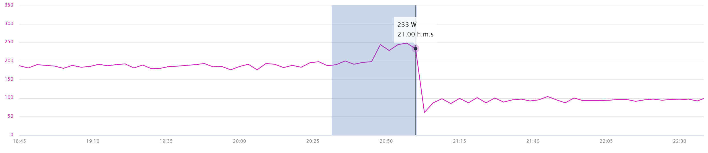

This is a graph generated from one of these workouts (Dec 18 th, Tacx Neo 2T) which had three repetitions of:
185W for 5 min
30s ramp up from 194W to 291W
95W for 2:30 min
The ramp up section is marked blue. As you can see, Zwift jumped to 195W and then directly to around 240W until the end of the ramp up. It seems that the power is updated every 15s. I saw that the trainer followed the power profile shown/set by Zwift. I see no reason why this should be an issue with the trainer.
Gerrie, the update interval of 15s might be the reason why your longer ramp-up section looks linear.

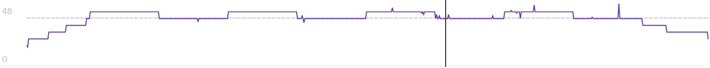

Strava power graph 20.12.2021. All steps rounded by 5 watts. 20,25,30,35,40W.

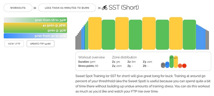

Main part intervals 35/40W
Workout main part have to be 35/38W
This is a kid’s workout.
Next strava snapshot 03.11.2021. No rounding.

I found your workout you mentioned on Zwift. It has a ramp up from 95W to 230W over 5 mins. If the power update interval is indeed around 15s, you should have had steps of 7W. So the ramp-up is long enough to look smooth.

Kid’s workout means that my 6 year old son is riding.
His FTP is around 50watts.
5 watts steps are to big for little kids.
