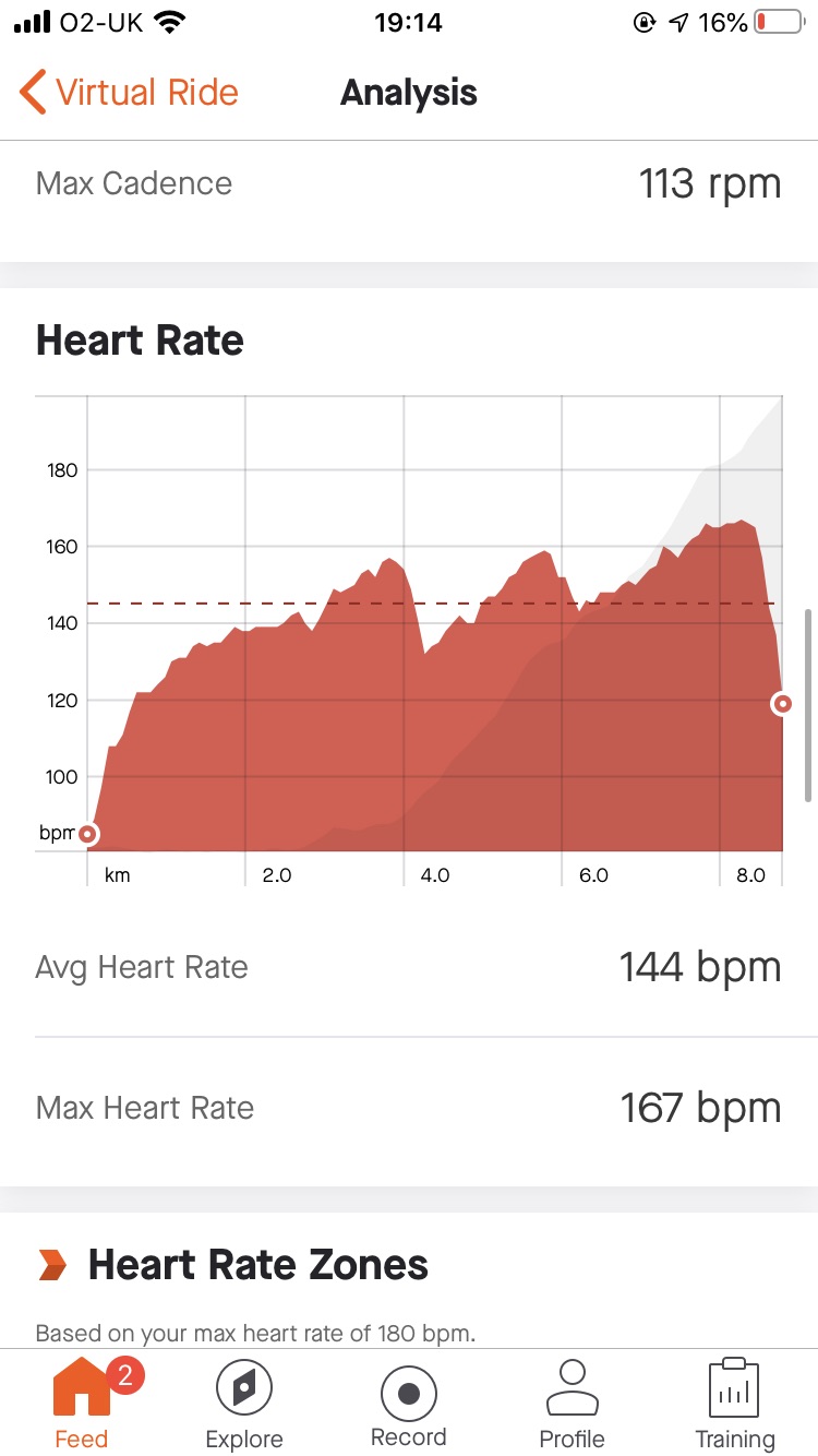

If these images work they are two different days of Emily’s short mix, it’s clear the difference in efforts
Have you considered you may be over-training? If that’s the case, you need to get off the gas sometimes… (as in “rest days are important” :slight_smile: )
Just my $0.02 …
That is a possibility, but pretty sure it’s computer issue not a fitness issue.
