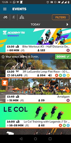

8 minutes before the event no alert on screen or in the companion app, i checked the companion app and i was ‘going’ was still highlighted for the event.

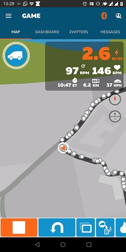

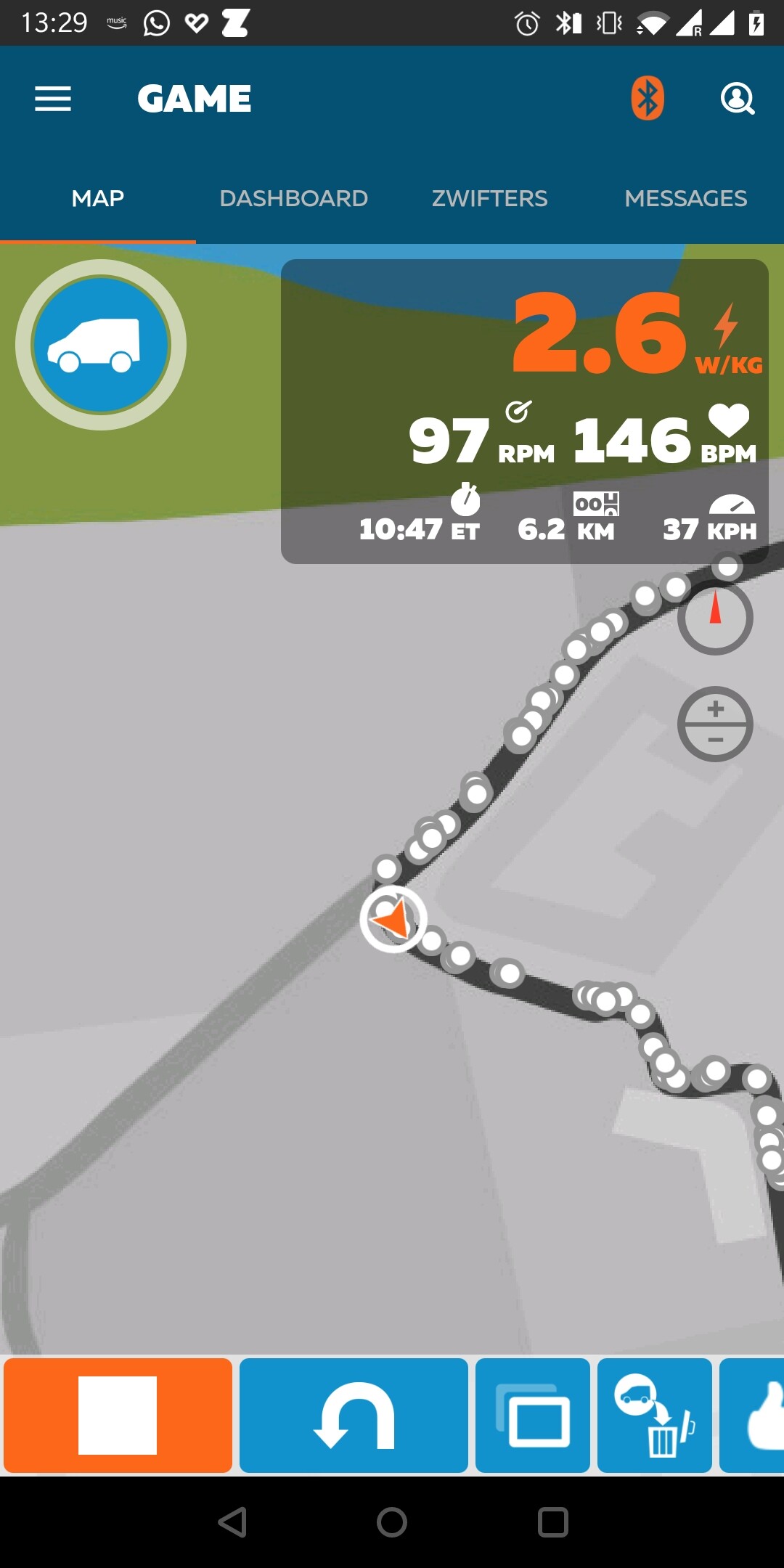

I was riding for 10:47 minutes as my event started and at no point did the companion app or the game app on my laptop prompt me to join.

  1. While you were riding did you see the map on the companion app? - I saw the ‘Greater London’ map that I decided to ride while I waited for the event to start. It worked as always. As did the Windows Zwift game app on my laptop.

  3. Did you use the companion app the sigh up? I used the companion app to sign up as I always do. Prior to October I occasionally had a problem joining events from Zwift. Since October i have had 7 event join failures despite being in the game well in advance of the event starting.

As I mentioned, the map on the companion app knew i was in game mode, i will try and attach the screenshots i took on my phone.
