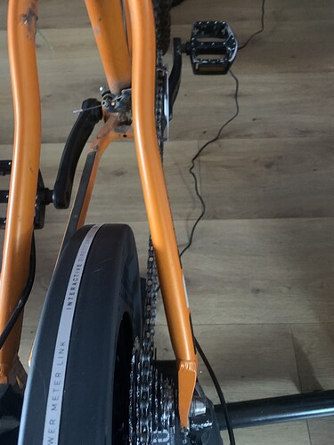

what cassette do you have on your zumo? ive got an 8 with 1 spacer and gearing sounds horrible so worry ive not got enough spacers or something
I’ve got an 11 speed cassette. With the right spacer your 8-speed should be fine. What spacer did you put on it? It might be the wrong one. But this is only likely to cause noise and problems with gear changes if it’s wrong, rather than to affect power.
Ive got a single 1.85mm spacer in there.
You’ve got the correct spacer then. Noise could just be that the trainer is sitting slightly differently than your wheel, hence it’s not quite matching up with the cassette properly.
