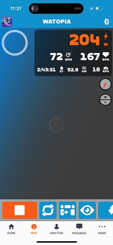

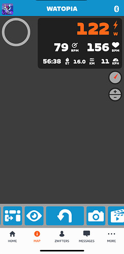

edit I’m now to section 5 and audit companion has blanked out. No time on first section but the rest have times now but I can’t see myself on companion. So like a similar bug last year but still there.
Added companion screenshot. No circle. No colors.
I’m happy to try anything to fix except end the ride. It’s already going to be a 2+ hour slog for me
Like that the whole way up. And now down with 8 kM left it’s like Emerging from a cloud cover -the trail on zwift companion comes back
