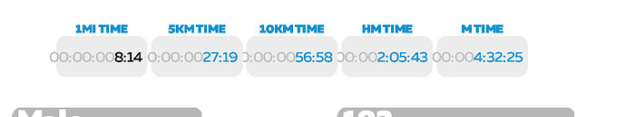

Please note that when I stopped the treadmill mid-workout, the Zwift app target speed changed to 0,2 kph. When I restarted the treadmill, the Zwift app measured speed was consistent with the speed set on the treadmill, but the target pace remained at 0,2 kph. It seems somehow that stopping the treadmill confused the Zwift app target speeds, not only for the workout but also for future workouts.
Please see also the pictures I’ve attached (one of a future workout for later this week, and one for my current paces).
Please see also my reply to Shuji: the target paces in my profile in-game look alright (although it’s slightly confusing to see all the grey "0"s in front of the actual times) but the target paces in the (future) workout remain at 0,2 kph.
Some of your target paces are way off, judging by your attached image.
Your 1 mile time is set to 7 hours, 0 minutes, and 11 seconds.
Your half marathon time is 107 hours, 8 minutes, and 10 seconds.
Your half marathon time is 232 hours, 9 minutes, and 29 seconds.
If I was you I would correct these and then everything should be much better in the workouts.
That seems to have fixed the issue in my future workouts, many thanks for your careful review and suggestion! (I somehow read those times as 7 minutes, 107 minutes and 232 minutes.) Still not sure what caused the reset to 0,2 kph in the first place, but after correcting the times the new target speeds seems much better. (I’m hoping the 5k run that’s later on in the training plan will set these speeds to something more accurate, but this is good enough for now.)
