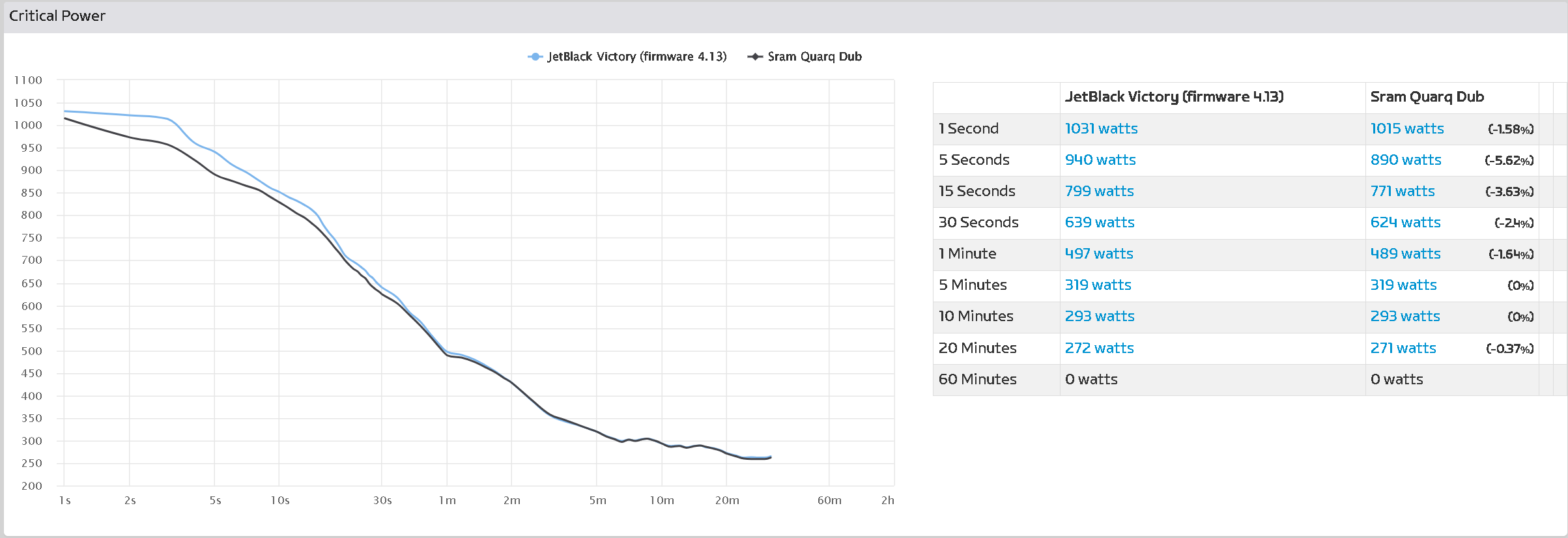

Here’s last week’s ZRL points race:
I use a SRAM spindle PM (left side only), so some mismatches at sprinting is expected.
