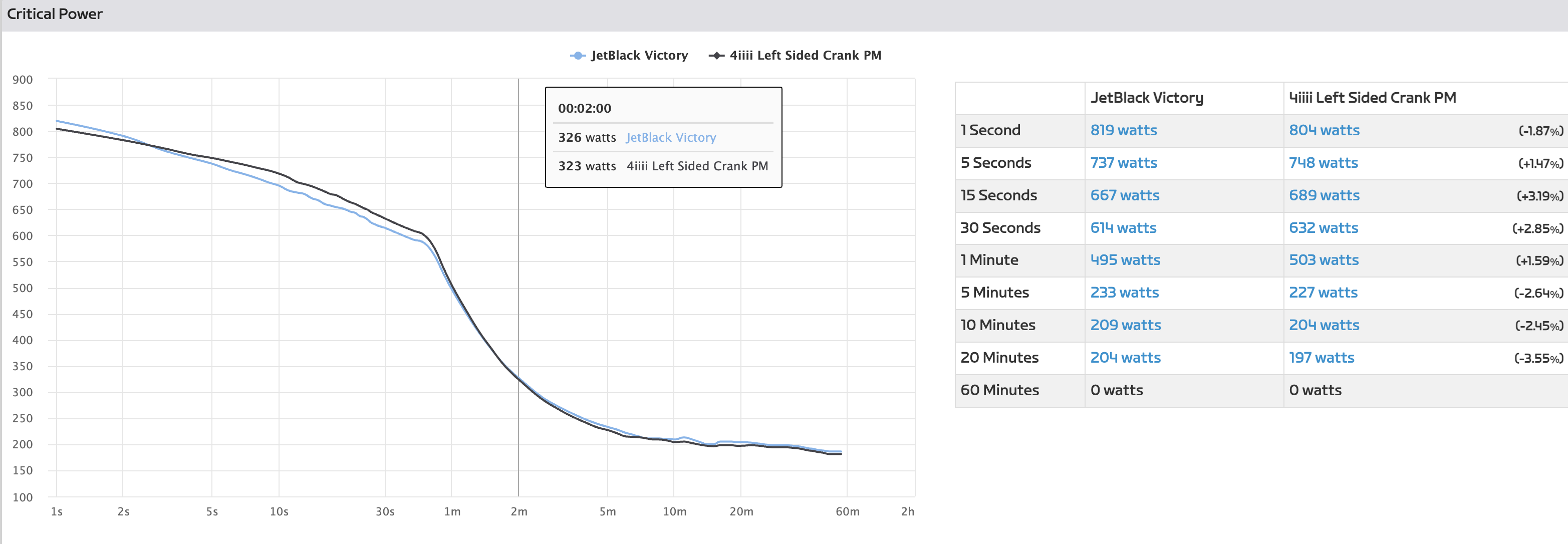

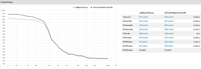

It seems much better so far. I’ve only done two rides on the latest FW last night, but no dropouts and the trainer connected in Zwift straight away. Before, there was some hesitation, as if it was struggling to find the connection. I didn’t have time to do a spin down calibration before the TDZ rides started, but the power data doesn’t seem too bad and it looks like it got closer on the second ride, after a bit of coasting and auto calibration:
This looks very promising! Mind if I ask what is the other power meter you are using to compare? I have the Assiomas and the Victory would always read higher (firmware 4.12.0).

It’s a 4iiii left-sided crank-arm power meter - I think it’s called the Precision 3+.
Thanks. Maybe I’ll have a go at that newer firmware and see if the power readings line up for me as well. :crossed_fingers:

Running 4.12.0 and 4.12.9 (haven’t tried the 4.12.10) and my power is about 3-5W lower than my Quark Power Meter which is perfectly reasonable.
With 4.9, the power was roughly 15w-20w lower. I retested it again last night with 4.12.9 just to be sure and it was, again, very close.
I’m not sure if I’m imagining this or not, but with 4.12.9 firmware, it seems like the power is more stable. It almost seems like they are sampling the power more consistently on the pedal stroke instead of grabbing some off-phase variations. I have a decent L/R imbalance (53/47) so my little graph in Zwift is sometimes a little jagged on the JBV, but my ride last night it seemed smoother. Again, very unscientific.
