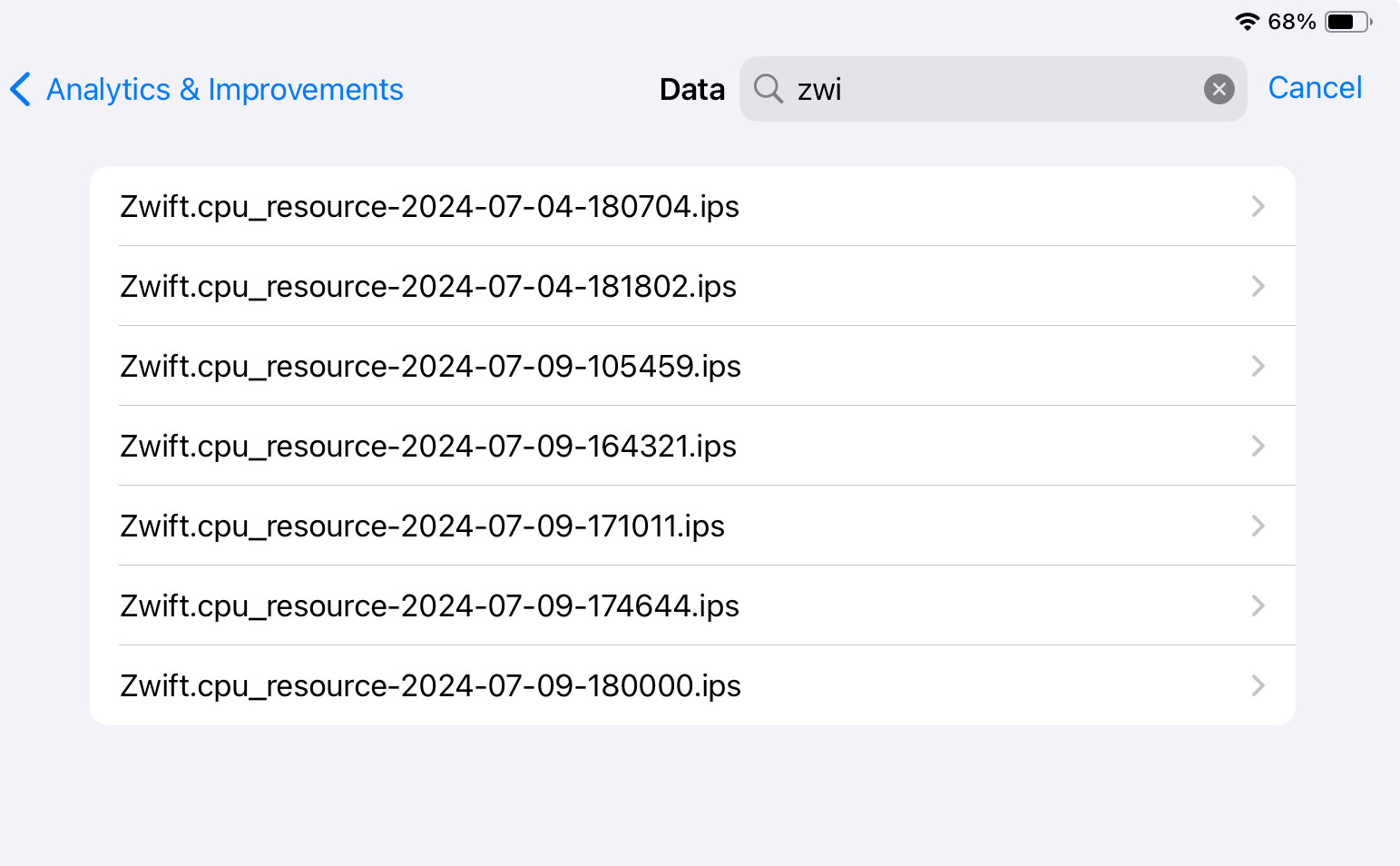

I’m having same issue on iPad Pro. It’s not just battery though, it’s higher cpu or gpu usage. There are big drops in fps and Zwift is not running as smoothly as it used to. Yesterday I did 2 hour ride on Tire-Bouchon in France and after one hour fps started dropping massively. I had around 5-10 fps dropping to around 0.5-1fps when robopacer with bunch of people were passing by. Framerate returned to normal when streak celebration screen appeared.
To amend my previous post, I’m certain that unexpectedly high cpu usage is the cause of battery drain. I found reports in system settings. Let me know if you want these reports, because I’ve got couple of them.
Edit: I share app reports with developers, so you should be able to find it in Xcode :slight_smile:

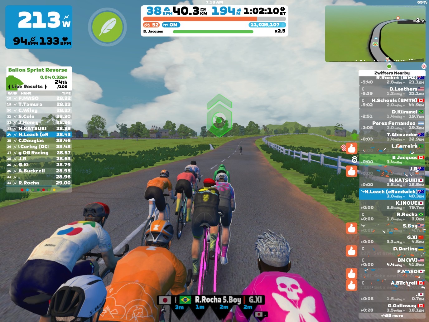

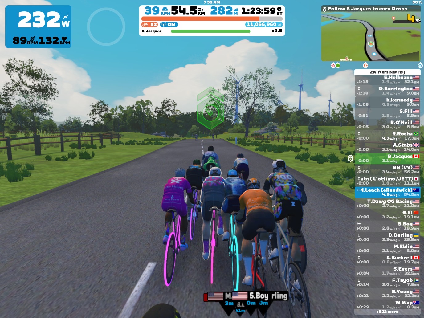

iPad battery drain still seems to be an ongoing issue - on this morning’s ride I lost 30% in 1h24m (~15% in the first hour, and then ~15% in about 22m):
I also experienced the slow framerate issue that others have mentioned and can send through a video of that if it would be of assistance.
