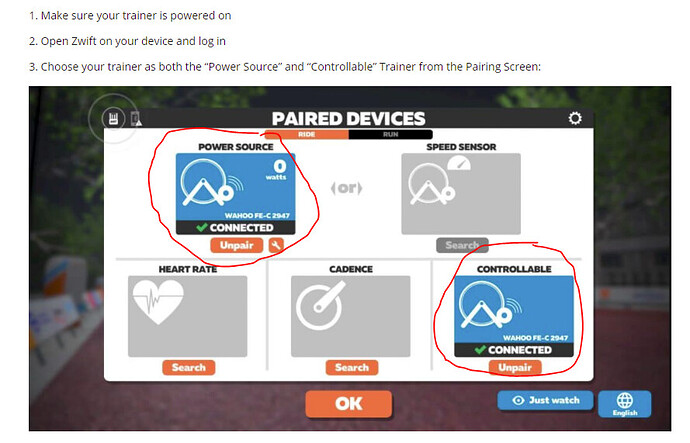

Hi @Philip_Marks_KWCC_40
What system are you using how do you pair the trainer.
If you use ANT+ do you use the FE-c option ?
Paired with Ant+ and selected the FE-C version.

And you did pair it as Power AND Controllable.
