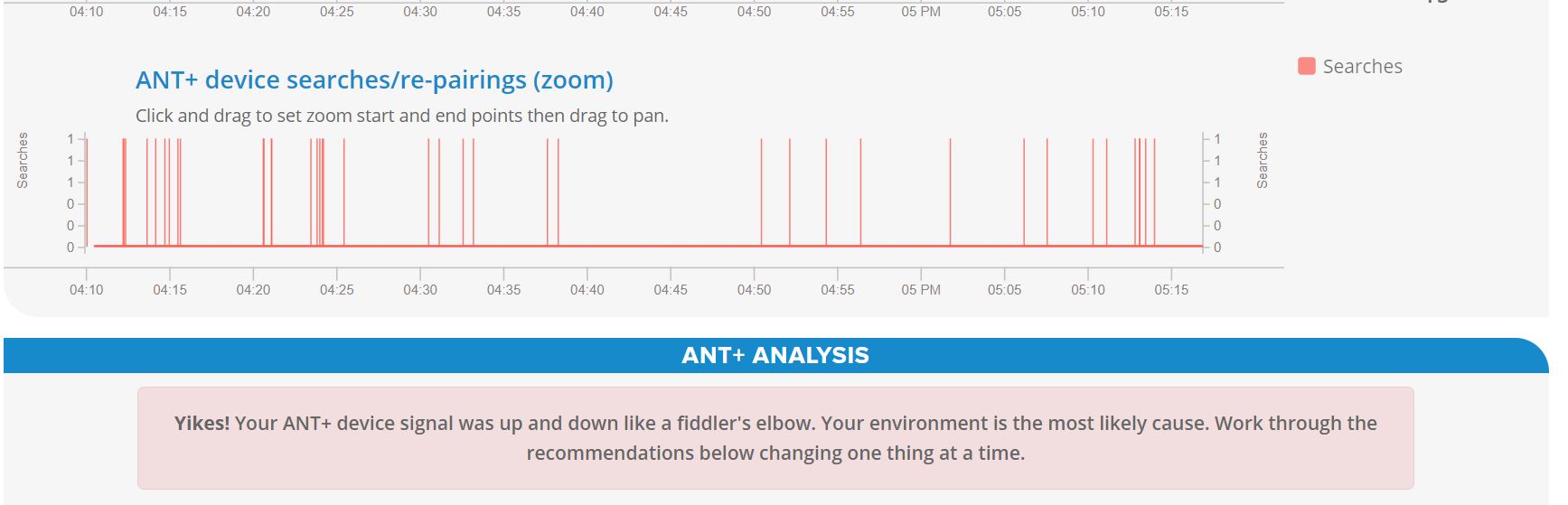

I finally got my ANT+ to produce a perfect result (see photo) but I am still getting dropouts on my Kickr Gen 1 and cadence sensor. The drops are not being reported in the Zwiftalizer report but I know they are happening because my rider stops and/or the cadence disappears for a few seconds. Functionality always returns after a few seconds but by then, I have either been dropped or failed the interval. Anyone else has a perfect ANT+ SIGNAL QUALITY but still experiencing dropouts?

That log file is only 5 minutes long? :flushed:
That log file looks to perfect do you have other log files.

Ah yes, just noticed that. Pulled the file from tonight and it looks like this.
Possible solutions:
  • Are you using an ANT+ extension cable to get the dongle closer to your trainer and bike?
  • Move your wifi to 5GHz if possible.
  • Try Bluetooth.
