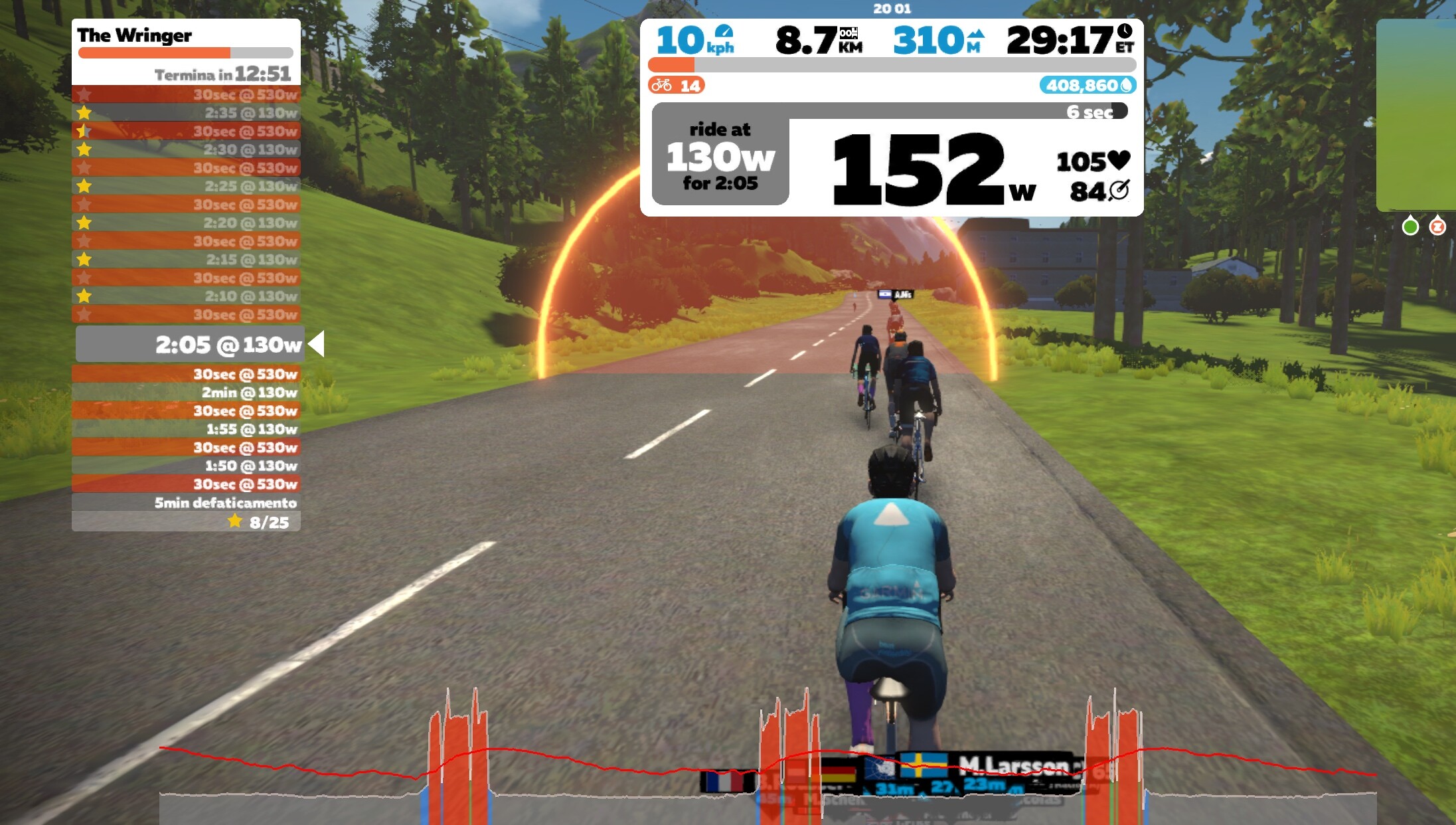

I’ve a lot of drop of power during both workouts (erg or no-erg mode) and also during free ride.
Some weeks ago the problem was only during workouts and with erg mode on, but in the last 2-3 weekend it got worse, and now every time I’m on zwift I’ve the same problem!
I’ve a macbook air and I’m connected via bluetooth with tacx flux smart s.
The curious fact is that these drops only happen when I’ve to increase the power, let’s say more than 180-200 watts, so alway in high intensity intervals during workouts and always when I’ve to climb during free ride.
When I’m on 130-140 watts it seems to be all ok.
These screenshots can explain the problem better than words I think ![]()
Thanks to everyone can help me ![]()
