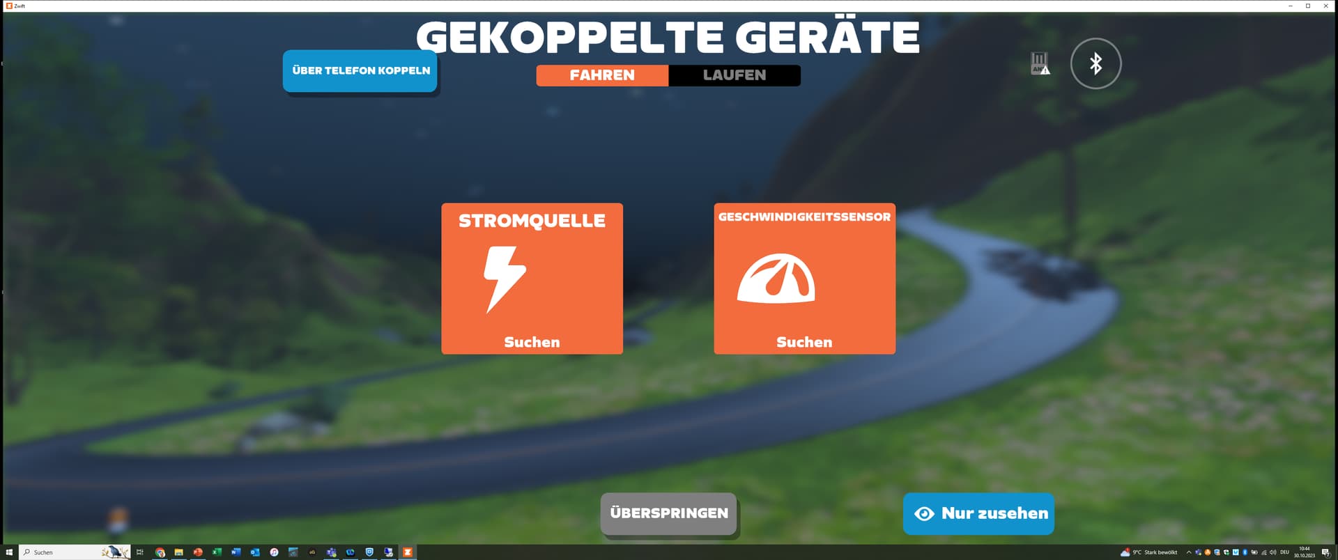

Yesterday when I`ve started the App it was not anymore possible to connect.
Also the connection options looks different than before …

Hi Martin,
Not quite sure if I have the solution. I also ride on a Tacx Neo, but I always connect it through ANT+ with an ANT+ dongle attached to my desktop pc. What could be the issue with your setup is that the Bluetooth connection is now used for the communication between your Tacx Neo and the Tacx app and blocking the access from Neo to Zwift. You may want to try and disconnect and / or disable Bluetooth on your device and then enabling it again. Then start Zwift and try to connect again to your Tacx Neo. If that doesn’t work, check if you have location services turned on on your mobile phone/device. Don’t know why, but it seems to be required, see also:

I’ve had similar issues with my NEO2T once in a blue moon. (read: infrequently) It’s usually fixed by force-closing all apps, restarting devices. Sometimes, it requires uninstalling Zwift and reinstalling.
The “I’ve tried everything and nothing works” options:
Now reverse everything - reinstall apps, paid ONLY from within the app - don’t use system-level bluetooth pairing.
Thank you for your help… It works again!
